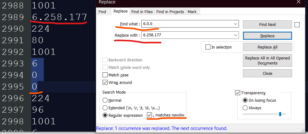

      So I was doing some things on notepad++ and I was trying to replace with Regular Expression but finds out it doesn’t abide by it’s options. Is there anything else I can do to replace with newline?

        You’ve told the software that you want a . in your find expression to possibly match a newline character – and that’s exactly what it is doing for you.
        It is hard to tell what you really want, but perhaps you want to do your search in Normal Search mode?

          @alan-kilborn I’m trying to replace multiple lines with a replacement with multiple new lines.

            @csyecokthesolly said in Replacement does not abide Regular Expression:
            OK, well then you can use Regular expression mode.
            You can use a \R in the Find what box to match a line-ending character when you search.
            In the Replace with box, you have to use, for Windows, \r\n when you want to insert a line-ending.

              @alan-kilborn Thanks. That problem doesn’t occur now.
