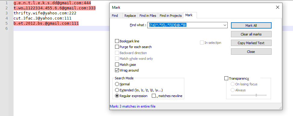

      I want to delete every line containing more then 3 dats on email, how to do it?
      So this 2 are good
      thrifty.wife@yahoo.com:222
      cut.3fac.3@yahoo.com:111
        Alan Kilborn @Marcin Tomczak
        @marcin-tomczak
        Seems like this would match the lines you don’t want. If you can match them you can delete them by replacing with nothing.
        (?-s)^.*?(\..*?){3}@.*\R
        Use regular expression search mode.
          But I gave a solution (above) for “3 or more” dots.
          Here’s the semi-obvious slight adjustment to do “more than 3”:
          (?-s)^.*?(\..*?){4}@.*\R

              I tried this what u gave me, one mail was deleted but for an example this still survive
              b.eth.2012.bs.@gmail.com:111
              Here we got 4 dats in email and he’s not deleted.
                PeterJones @Marcin Tomczak
                @marcin-tomczak ,
                First, @Alan-Kilborn was the one who gave you the expression, not I. He deserves credit.
                And I say credit, not blame, because his expression works on the address you just shared.
                g.e.n.t.l.e.k.s.dd@gmail.com:444
                t.wo…1122334.455.6.6@gmail.com:333
                b.et.2012.bs.@gmail.com:111
                If your expression is not matching that last address, then you have not correctly used Alan’s expression.
