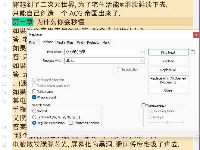

      Hello there, I’m sorry for my bad at English, but I really need you guys for help.
      I have a bunch of novel text have this problem, example like this:
      第一章  <-(this mean Chapter 1,章 mean Chapter, 第 not really important)
      第八十一章 <-(this mean Chapter 81)
      I want to change the construct of text from:
      第一章
      to
      章:一
      第八十一章
      to
      章:八十一
      Many thanks.

          Hello, @bạch-lão-bản, @Stefan-pendl and All,
          Not difficult with regular expressions ! Basically, you have this kind of text :
          • The 第 char, then a range, possibly null, of character(s), then the 一章 characters
          And you expect :
          The 章: char, followed with this same range of char(s) and ending with the 一 char
          In regex language, this can be coded as :
          SEARCH (?-s)第(.*)一章
          REPLACE 章:\1一
          So :
            • SEARCH (?-s)第(.*)一章
            • REPLACE 章:\1一
            • Tick the Wrap around option
            • Click once the Replace All button or hit the Alt + A shortcut
          • Close the Replace dialog ( Esc )
          Notes :
          • The (?-s) part forces the regex engine to consider any dot regex symbol ( . ) as matching a single standard character ( not line-break ones ! )
          • Then, the part .* represents any, possibly null, range of standard characters, between the 第 char and the 一 char. As it is embedded between parentheses, it is stored and can be re_used, either in the Search regex part with the \1 syntax or in the Replace regex part with the \1 or $1 or ${1} syntaxes
          • The four characters 第, 章, : and 一 are just literal chars to be searched and replaced as it is !
          • Bạch Lão BảnB
            Bạch Lão Bản @Stefan Pendl
            @Stefan-Pendl @guy038
            Thank you, this problem finally solved :D
