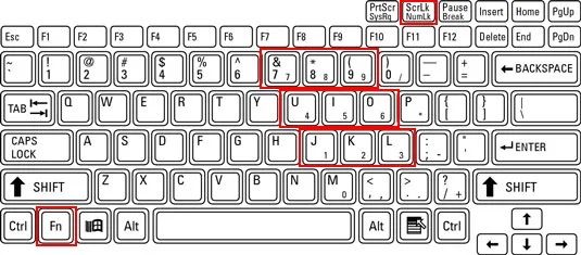

      Method B – How to use ALT codes on a laptop keyboard without a dedicated
      numeric keypad (On-Screen Keyboard)
      On a laptop keyboard, a set of keys have a secondary function, that when
      enabled, makes them act as a numeric keypad, as shown in the image below:
      1. Locate the Function or Fn key on the bottom left of the keyboard.
      2. Locate the Num Lock or Num Lk key on the top right of the keyboard.
      3. Press and hold the Fn key, press and release the Num Lk key, release the
        Fn key. The laptop’s numeric keypad is now enabled.
