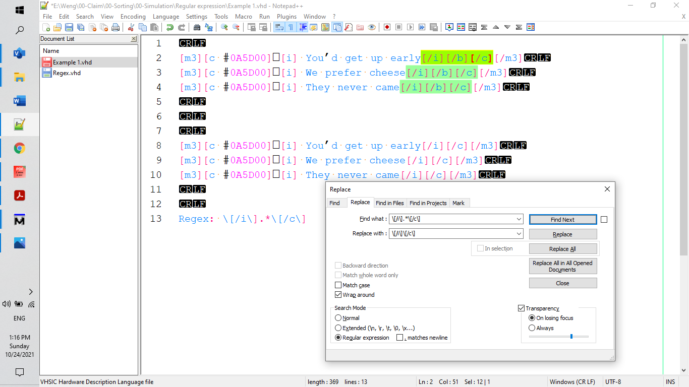

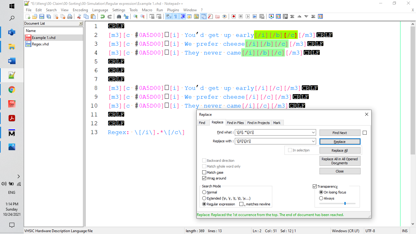

              Here is the answer you want:
              Command is:[/i].*[/c] to search for what you want to find
              At replace position to enter what you want to replace:
              In your situation, replace = [/i][/c] to delete what you want to delete.
              comment:
              [] are metacharacters, if it is used, use ‘’ before ‘[’ to represent ‘[’ character
              .: Matches any single character (many applications exclude newlines, and exactly which characters are considered newlines is flavor-, character-encoding-, and platform-specific, but it is safe to assume that the line feed character is included). Within POSIX bracket expressions, the dot character matches a literal dot. For example, a.c matches “abc”, etc., but [a.c] matches only “a”, “.”, or “c”.
              : Matches the preceding element zero or more times. For example, abc matches “ac”, “abc”, “abbbc”, etc. [xyz]* matches “”, “x”, “y”, “z”, “zx”, “zyx”, “xyzzy”, and so on. (ab)* matches “”, “ab”, “abab”, “ababab”, and so on.
              Then use the replace key with item = what you want. In your case just delete “.*” in find command
              Tips:
              1. Before using Regex, at NP++, click View --> Show Simble --> Show All Characters as shown in pictures.
              2. Before replacing, click “Find Next” and it will show you what you want to identify.
