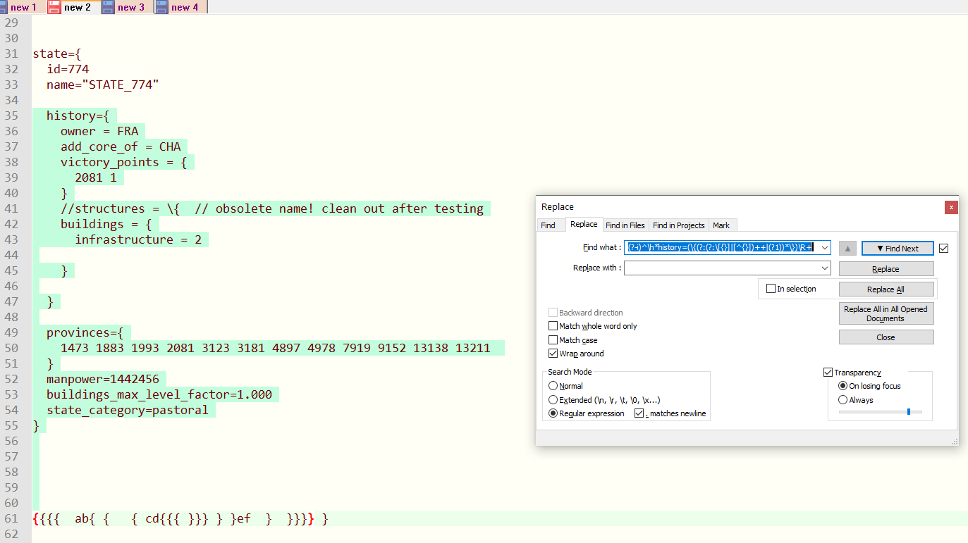

            Hi, @mleczny-sernik, @neil-schipper, @terry-r and All,
            Neil, to solve the case you mention, we have 3 possibilities :
            • The first possibility is quite obvious :
              • Open the Find dialog ( Ctrl + F )
              • Type in a { or a } char in the Find what zone
              • Tick the Wrap around option
              • Click on the Count button
              => The number of { chars must be identical to the number of } chars ! If not, the program’s logic is broken and I wish you good luck to identify the missing or extra brace !
            • The second possibility is to decide that an escaped { or } char will be considered as a normal character, different from [{}].
              • => Any allowed character, inside a {•••••} section, is represented by the regex (?:\\[{}]|[^{}])
              • Then, the search regex to use becomes (?-i)^\h*history=(\{(?:(?:\\[{}]|[^{}])++|(?1))*\})\R+
              • Of course, your comment line must then be re-written as //structures = \{ // obsolete name! clean out after testing
            • The third possibility is to use the following regex which identifies the longest contiguous zone with an identical number of opening brace and ending brace character(s)
              • This magic regex is (?:[^{}]*(\{(?:[^{}]++|(?1))*\}))+[^{}]*|[^{}]+
              • Do not tick the Wrap around and perform some tests, moving the caret to different locations, in your program, which should help you, to some extent, to spot the guilty brace char !
              • Note that a simple text, without any brace char, is also matched by this regex. Logical, this text contains the same number of opening and ending brace chars : 0 ;-))
            P.S. :
            You may test the regex (?:[^{}]*(\{(?:[^{}]++|(?1))*\}))+[^{}]*|[^{}]+ against this text, pasted in a new tab :
            {{{{ab{{{cd{{{}}}}}ef}}}}}}
            1234  567  89198765  43210x

              I played with your bullet 3 regex against your sample text. It works, and it’s very cool.
              If you wished (and you do not need to prove yourself as someone who likes challenges – I for sure would not try it) you could try to make it so that on successive Find Next clicks, rather than resume from text after the entire prior match, it could crawl from where prior match started to the next open brace and go from there, allowing user to see the enclosed region shrink bit by bit… Leading to the next challenge: going left bit by bit, and watching the region grow… maybe that’s too many levels of super-cool, I dunno… and then I remember that I/we already get matching brace highlighting (maybe only for some known languages?) (I forget if it’s a native Np++ feature or provided by a plugin.)
              I tried the regex in your 2nd bullet and although it still works against the original sample code, it’s not working for me with that extra line I threw in, with the open brace but backslash-escaped. Don’t know why, and I’m not inclined to try to debug it; I’m really a noob in regex flow control.
              Your conclusion in Bullet 1 is not strictly correct (unless file were stripped of all comments) but it’s not worth sweating about.

                  Now, regarding the second bullet of my previous post (?-i)^\h*history=(\{(?:(?:\\[{}]|[^{}])++|(?1))*\})\R+, if I escape the opening brace, in you comment line, as a convention which changes the brace as an ordinary character, giving this history section :
                  history={
                  		owner = FRA
                  		add_core_of = CHA
                  		victory_points = {
                  			2081 1
                  		buildings = {
                  			infrastructure = 2
                  The regex does match all the section ! So could you show me an example where the regex fails to match this history block ?
                  Finally, my answer, in bullet 1 was, indeed, rather vague and I suppose that most IDE has tools to identify and correct the unmatched blocks of programming languages ! But running first my simple work-around means necessarily an error when numbers are different, isn’t it ?

                      @guy038 said in Replacing text from x to y:
                      I’m seeing it match past end of state’s } (includes all trailing newlines) rather than past history’s as desired:
                      v7.9.5 64-bit
                        @neil-schipper,
                        Ah, yes ! I needed to indicate two consecutive \ characters in the regex ( in order to search for a literal \ char ! )
                        So the correct regex is rather :
                        (?-i)^\h*history=(\{(?:(?:\\\[{}]|[^{}])++|(?1))*\})\R+
                        • Neil SchipperN
                          Neil Schipper @guy038
                          Confirmed. In hindsight I should’ve spotted it myself – every instance of backslash-leftbracket on this site should be treat with suspicion and caution.
