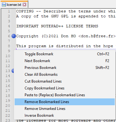

          Alan Kilborn @Terry R
          @Terry-R said in Remove every row with a number less than 1000 up to the first delimiter:
          …happy that the marking is correct click on “Remove Bookmarked Lines” which is under Search, Bookmark, that removes those rows.
          A quicker way to get this menu to appear is to click in the margin that contains the purple ball bookmarks, like so after the right-click:
          Note the right-click point was after the 9 of line 9, directly between the two bookmark symbols. If you squint you can see that this margin is a slightly different shade of grey than the line number margin.

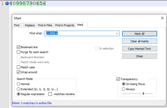

            @Eric-Tilley said in Remove every row with a number less than 1000 up to the first delimiter:
            Unfortunately, this did not produce the output I desired, and I’m not sure why. Could you please help me understand what went wrong
            I had a look at your solution and realised you made the mistake of using “meta-characters” where they don’t apply. I suggest reading the online manual for allowed “extended search” characters here. The [ and ] mean exactly that in extended mode, when used in “regular expression” mode they refer to a set that is contained within. And there was your second problem, each of the characters except for the - are tested individually. So in essence your set was numbers 1-9 (usually use 0-9), the 2 extra 9’s following were just a duplication of the preceding 9.
            So your expression said find as many numbers which are using ONLY 1-9 (excludes the 0) together. See my example below to see what results in. The same result occurs when using [1-9]+.
            I think you will find a mine of information if you go through the FAQ section of this forum. Specifically the regular expression detail in the post here.
