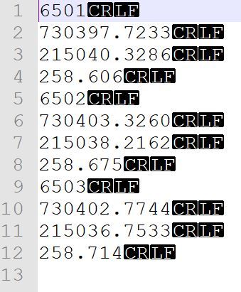

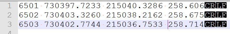

      Hi. I am trying to remove the line \n in Notepad++in some lines and replace it with a tab \t or a space. In the pictures it is (visually) better explained.
      The data consists of variables with point name Y X H (4 elements). Now the \n up to the 4th element should be replaced by a \t or a blank. Then a \n should create a new variable in a line.
      So convert the first 4 lines into one line and then repeat the loop.
      Input Data
      Output Data
        PeterJones @Thomas Klinghan
        @Thomas-Klinghan
        FIND = (?-s)(^.*$)\R(^.*$)\R(^.*$)\R(^.*$)
        REPLACE = $1 $2 $3 $4
        REPLACE ALL
