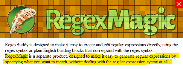

                          Alan Kilborn @Neil Schipper
                          @Neil-Schipper said in Find a specific sequence on every line:
                          it’s intriguing to imagine an engine behind a friendly interface asking users to specify key aspects of their requirements in natural language
                          That would be, well, pure “magic”:
