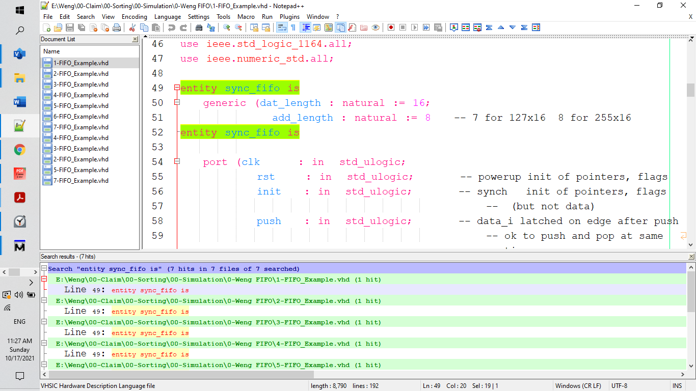

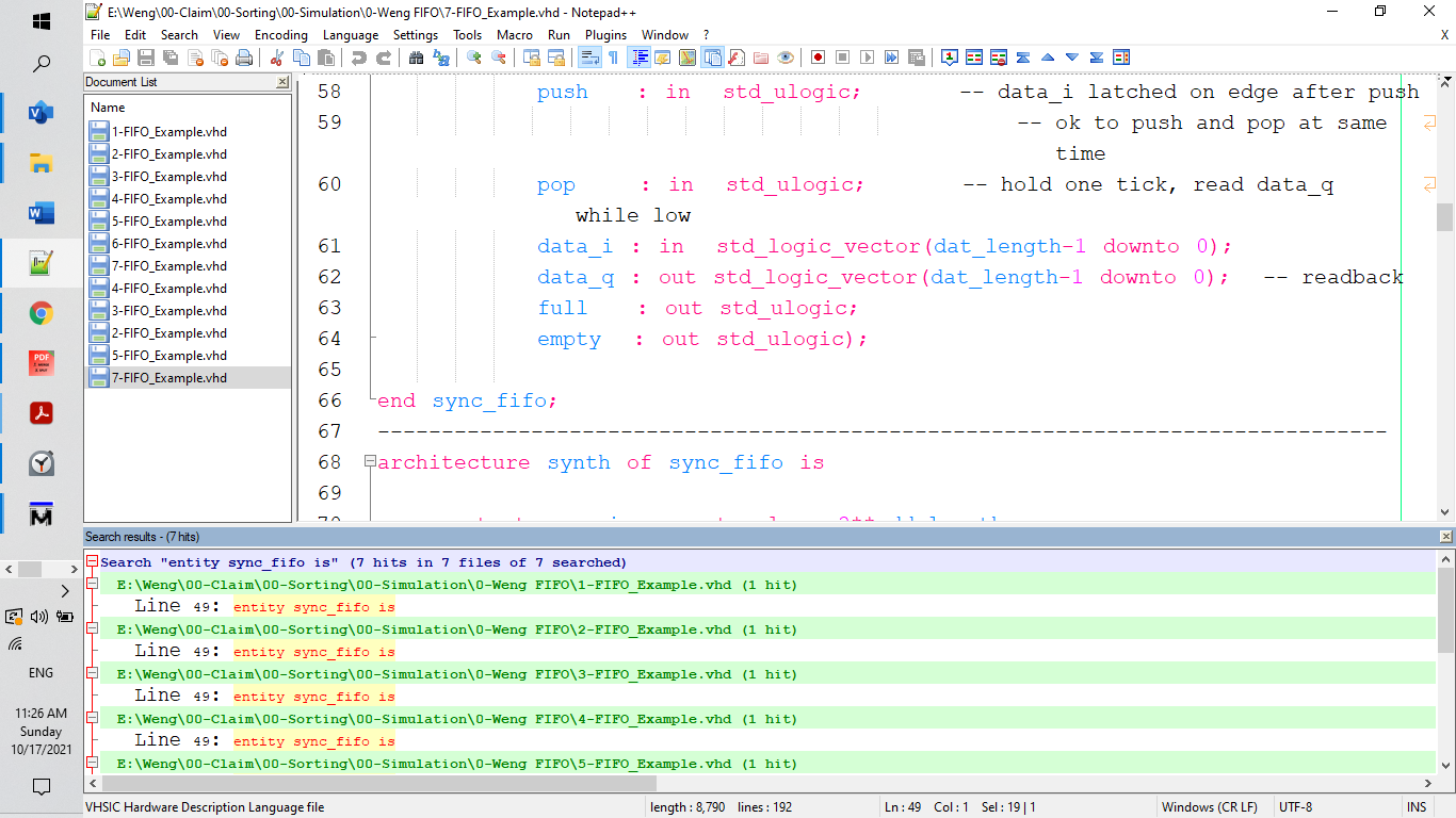

          Here are snapshots that should give one a very clear picture of what improvement should be made and where the bug is located. I list one suggested improvement post each time so we can focus on only a small step and you know what I describe.
          All files are the same for show example purposes.
          Problem 1: there are many files having double views, one cannot recognize which one is at the upper pane or low pane.
          Suggested Improvement:
          1. All files belonging to the upper pane or low pane should have different color icons.
          2. All files belonging to the upper pane should be listed at the upper part of the document list pane, and all files belonging to the low pane should be listed at the low part of the document list pane.
          3. There should be a line separate the upper pane file names from low pane file names.
          Alan KilbornA Neil SchipperN 2 Replies Last reply Reply Quote 0

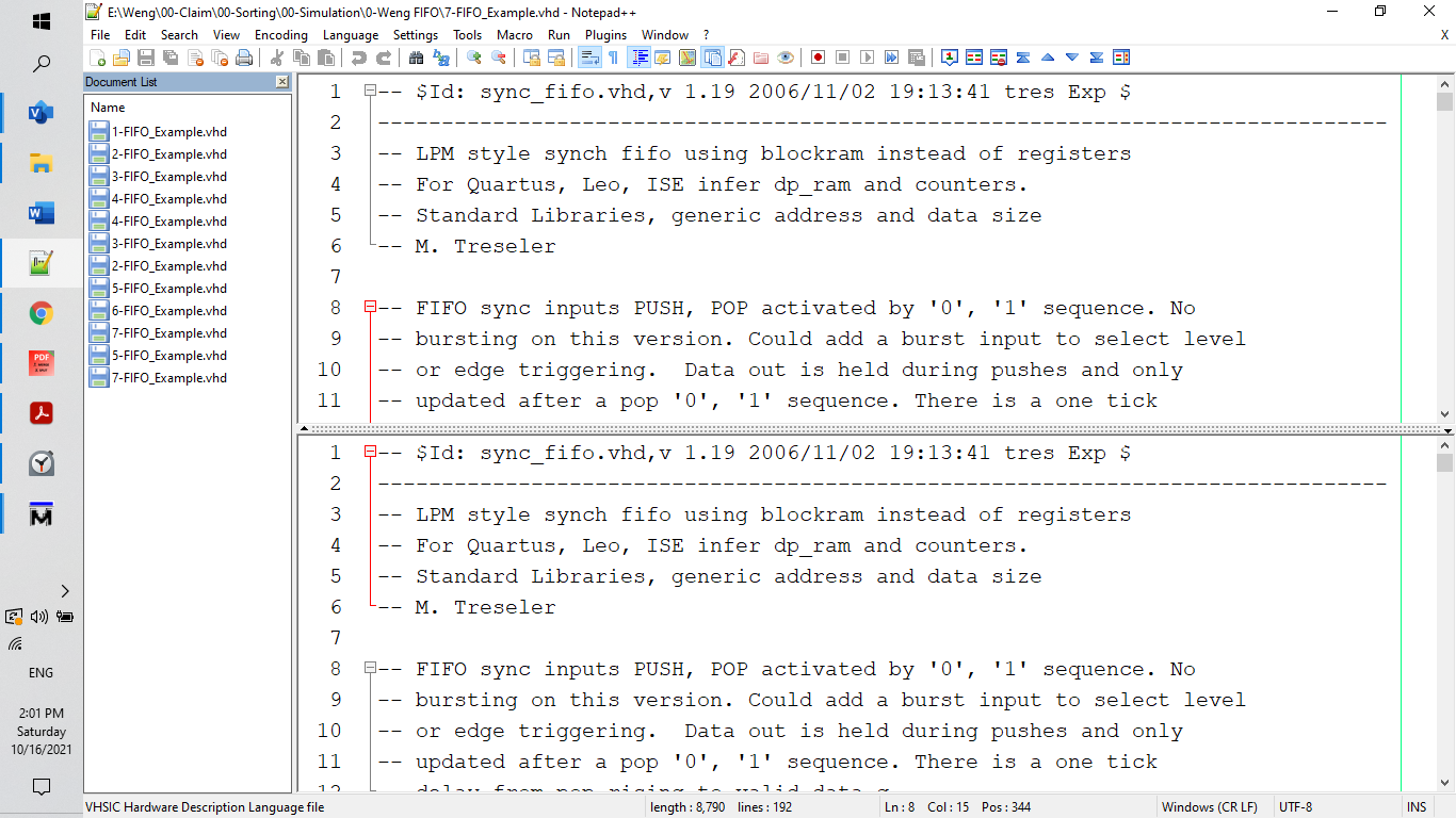

                The above two panes show where the bug starts: a file in the document list pane has 2 views.
                Move horizontal bar between the upper pane and the lower pane upperward to hidden the upper pane and maximize the lower pane. Click Ctrl+F keys to pop the “find window”, click the button “Find All in All Opend Documents” and get the following search result.

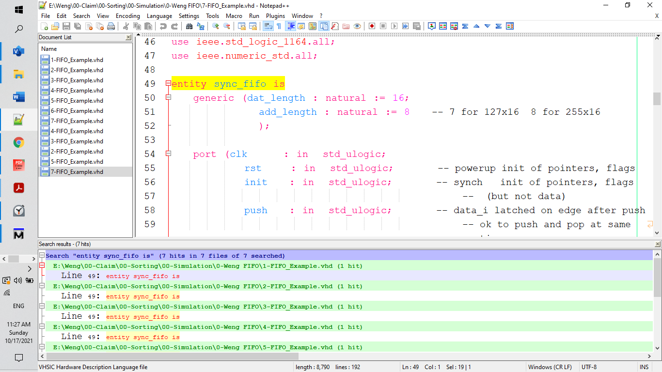

                It has no problem, everything is normal.

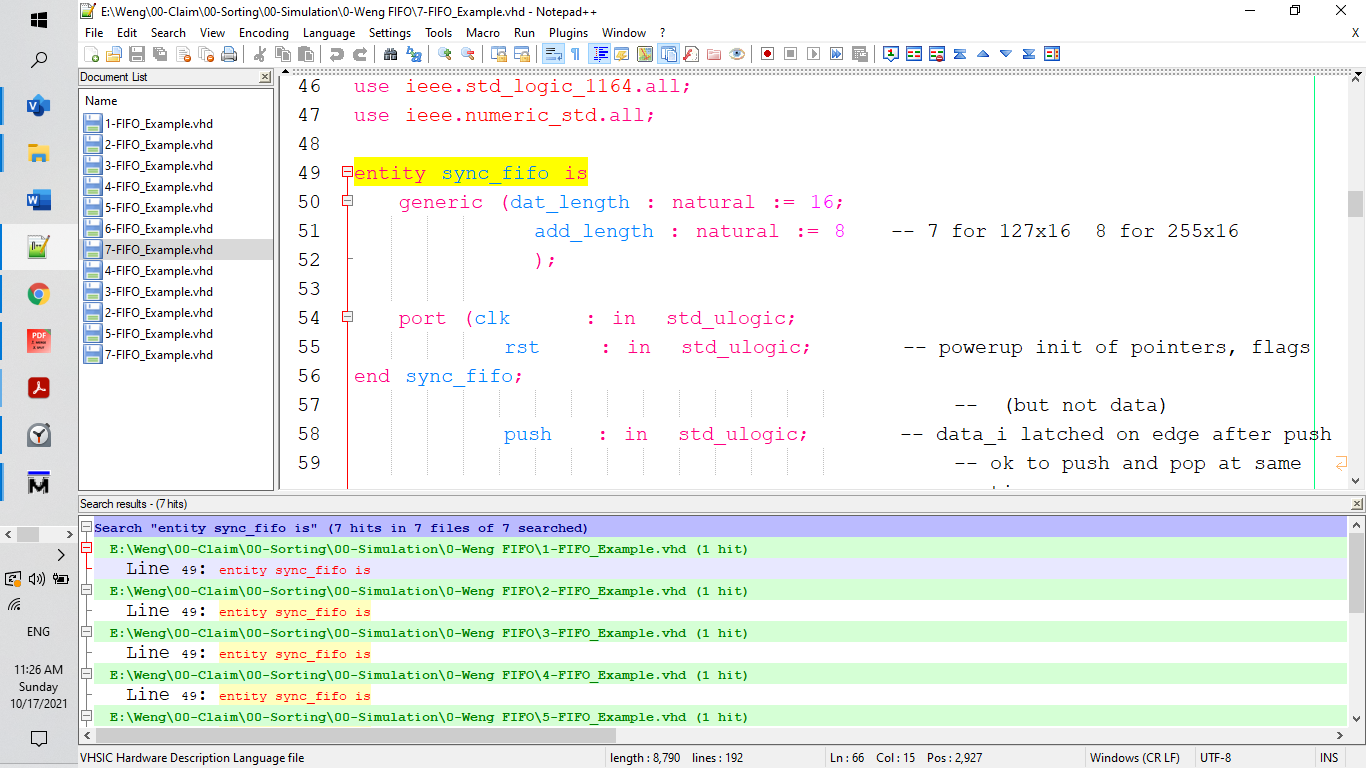

                It has a problem! I clicked the search result for 1-FIFO-Example, but it shows 7-FIFO-Example as shown in the document list pane. It enters the bug.

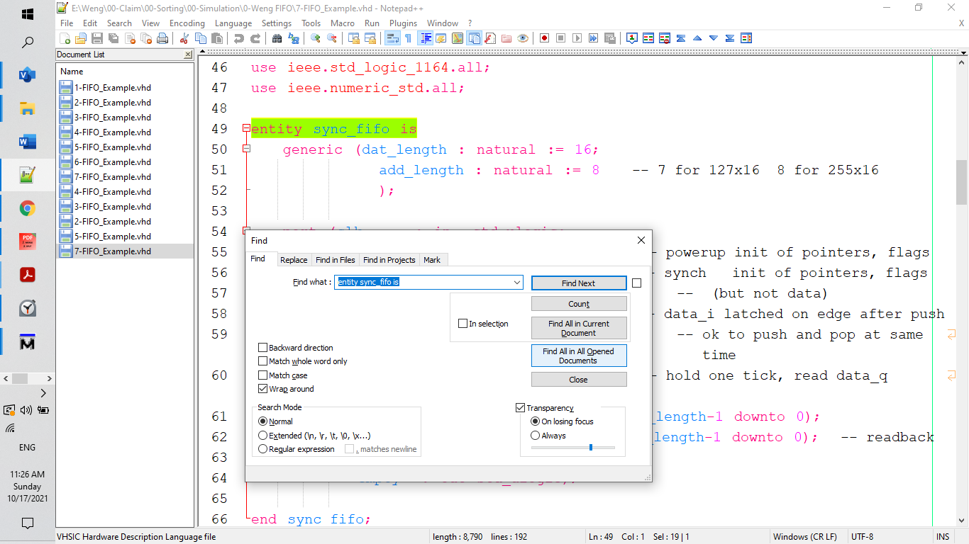

                I clicked the last 7-FIFO-Example in the document list pane; it returns normally.

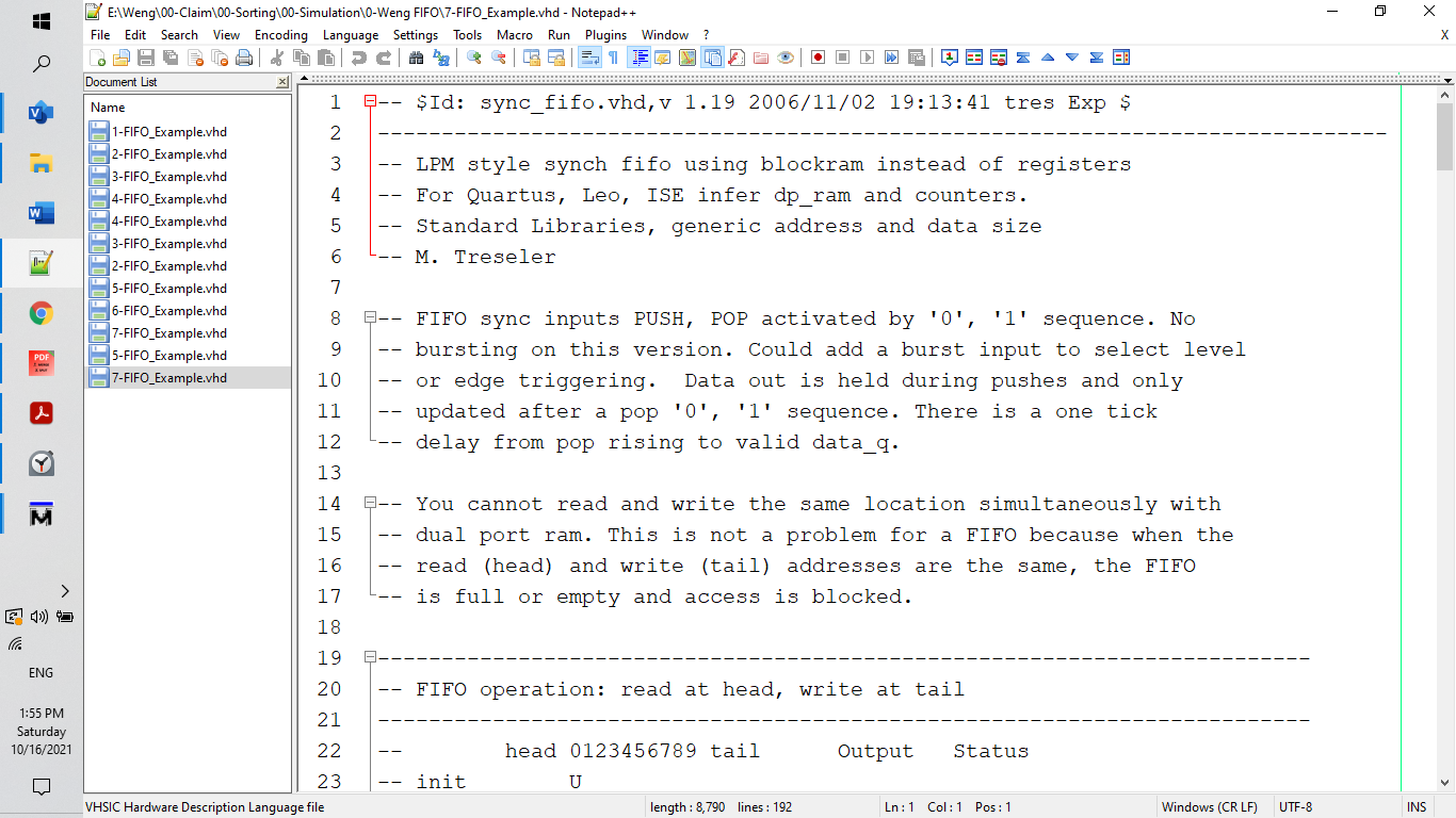

                I further clicked the first search result for 1-FIFO-Example, it suddenly shows 2 same lines: “entity sync_fifo is”. And I found the situation becomes unstable, so I stopped immediately to avoid any damage to the edited files.
                There is my analysis of the conditions under which the bug appears.
                1. The document list pane is opened with at least one file having 2 views.
                2. Move the horizontal bar between the upper pane and lower pane to hide the upper pane and maximize the lower pane.
                3. Do a search with multiple files selection.
                4. Click the mouse left bottom at the search results pane to show a selected file search position that belongs to the upper pane.
                5. The bug happens.
                6. If the mouse left bottom at the file content pane is clicked to try to edit the file, a bug appears and the editor enters an unstable condition.
                The description of the bug conditions is slightly different from the copied snapshots, the reason is when it is entered into described conditions status is always unstable and has many different bad and unpredictable behaviors.
                Here is my observation of why the error happens.
                The bug is closely related to 2 view pane scheme. When one view pane is maximized and another pane is hidden and do a search for multi-files.
                After the search, the maximized pane is the main pane. After clicking the search results pane for a file with the same pane, there is no error; when clicking the search results pane for a file with a different pane, the error appears.
                The handling of the document list pane should be improved while the same bug would be corrected and disappear.
                The 2 view mechanism is a very useful tool. When it is to compare one file with another file 2 views mechanism is necessary. But for most of the time, a Notepad++ user always prefers using one maximized pane and one hidden pane. He does not care about whether a currently edited file is in the upper pane or the lower pane. So the software designer should have such a design that when a file in the document list pane is clicked, it is always automatically shown in the maximized pane and the maximized pane setting is changed accordingly and belongs to the file. Currently, when a view pane is maximized and a file belonging to the hidden view pane is clicked, it shows nothing changed in the view pane because the hidden pane is hidden and the user has to manually move the separation bar to show the hidden file. The current design is not a good decision, it generates the bug I have showed and it also causes an uncomfortable edit environment.
