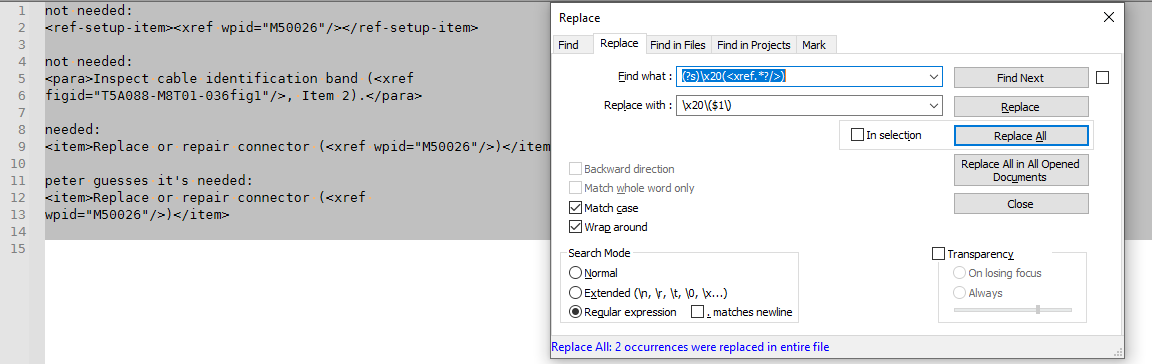

        FIND = (?s)\x20(<xref.*?/>)
        REPLACE = \x20\($1\)
        MODE = regular expression
        gives:
        not needed:
        <ref-setup-item><xref wpid="M50026"/></ref-setup-item>
        not needed:
        <para>Inspect cable identification band (<xref
        figid="T5A088-M8T01-036fig1"/>, Item 2).</para>
        needed:
        <item>Replace or repair connector (<xref wpid="M50026"/>)</item>
        peter guesses it's needed:

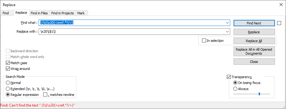

            Humm. It didn’t find any matches.
            Here is a code example it did not find:
            <para>Install LSB cover assembly <xref wpid="M40032"/>.</para>
            I’m using Find in Files

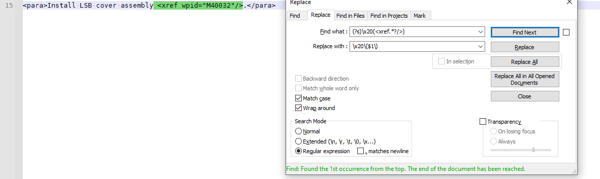

              It matches that text for me in a single file
              I made two files, each containing:

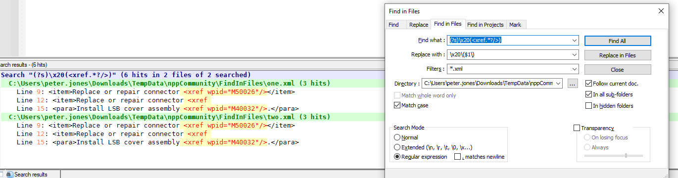

              Then I ran Find in Files > Find All, and it worked as expected, finding 3 instances in each that matched:

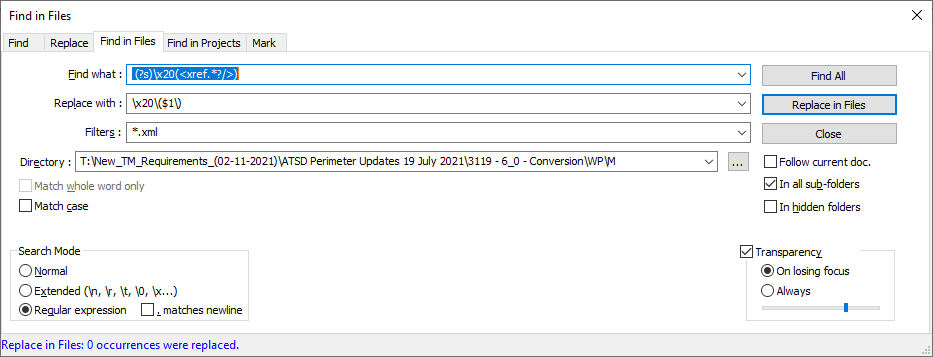

                So odd. I can’t see what I’m doing different/wrong?
                I tried a single file containing search criteria:
                Still not finding it?
                Ideas?
                Richard HowardR 1 Reply Last reply Reply Quote 0
                • Richard HowardR
                  Richard Howard @Richard Howard
                  @Richard-Howard
                  I think I got it Peter.
                  I must have had a space in the front of the Find criteria.
                  It’s finding it now.
