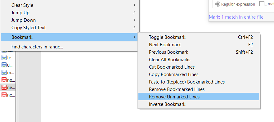

      I am facing some problem understanding the Bookmark -> “Remove Unmarked Lines” option.
      The debug info from my notepad++.
      Notepad++ v8.1.4 (64-bit)
      Build time : Aug 21 2021 - 13:04:59
      Command Line :
      OS Version : 1909
      OS Build : 18363.1801
      Plugins : LocationNavigate.dll mimeTools.dll NppConverter.dll NppExport.dll
      I have 3 lines in text window, I searched for one line and marked it. Then I selected the Bookmark -> “Remove Unmarked Lines” option to remove the unmarked lines, but surprisingly all the lines were removed. Note this is an example only, I am facing same problem with a text content of production error lines which I cannot share here.

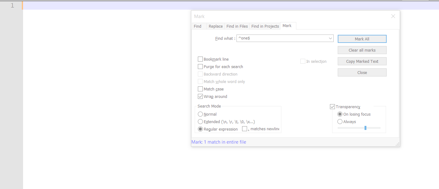

      3 lines with one marked using regex ^one$
      chose option to remove unmarked lines.
      All lines are removed.
      Could you please help to understand how to remove lines which are not marked?

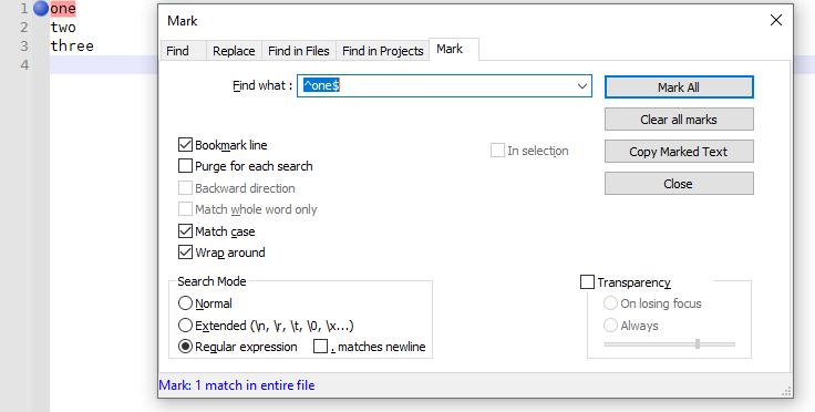

        PeterJones @premkumar bhaskal
        @premkumar-bhaskal ,
        You have confused “Marks” with “Bookmarks” – they are similarly named, so it’s understandable.
        If you added the “Bookmark line” checkbox in the Mark Dialog, and Mark All, then it will add a circle ⚫ to the left of any lines that have a Mark (which is indicated by the change in color on the specific text); this ⚫ is the Bookmark.
        After adding those Bookmarks, now Search > Bookmark > Remove Unmarked Lines will keep the one line.
        There’s a (relatively new) section in the online usermanual that compares Bookmarks vs Marks
