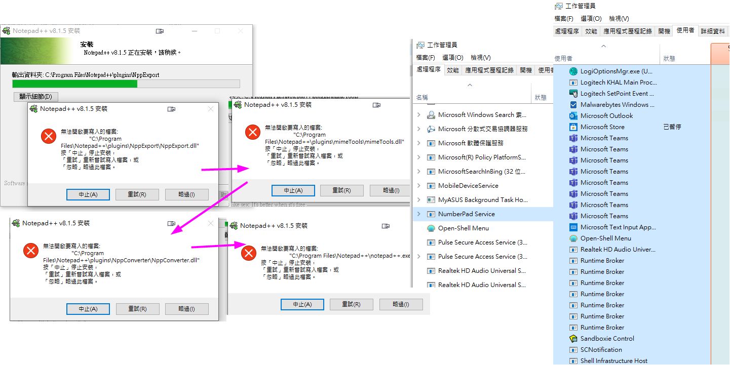

      Hi
      Notepad v7.x upgrade to v8.x or v8.x to the newest version.
      some files always cannot replace by the newone.
      1. Nppexport.dll
      2. mimetools.dll
      3. nppconverter.dll
      4. notepad++.exe
      If I launch notepad++ once, then start the upgrade procedure, it will happen the file cannot replace by the new one. also, use the explorer right menu to check something or open by notepad++
      when I didn’t launch notepad++ after windows start, the upgrade procedure is ok to replace by the new one.
      OS: Win10, 21H1 with last windows update or 20H2 with last windows update
      Notepad++: v7.x to v8.x or v8.x to last one. for now, the version is v8.1.5.
      Check: windows task manager cannot see any notepad++ sessions.

        The images you provide are not showing the error messages for the 4 files in english words, can you interpret those and explain in english what they mean? Your post refers to checking if files are locked by being in use at time of installation, is that what the error messages are saying?

          Yes, it isn’t accessible to upgrading.
          The image is the message from the notepad++ upgrade process.
          the message is the files are locked, and it cannot overwrite them. the notepad++ wants me to abort/continue/ignore.
          I try to install notepad++ in user mode or administrator mode. And the issue is the same.
          I think the issue is not read/write permission, and it’s a notepad++ issue. b
