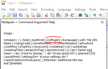

            One of the tests you can perform is to run Notepad++ (NPP) without any plugins. Depending on what version of NPP you have the command line argument can be different to what I show. Use the ? menu option, then “Command Line Arguments” to get your argument, but mine (on ver 8.1.5) is:
            Try that to see if it helps. Let us know that result along with debug info.
