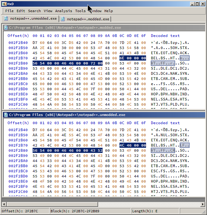

          astewart77 @gstavi
          @gstavi said in Replace line end symbols?:
          these symbols come from Scintilla so you should check out there.
          They are Scintilla representations and there are Scintilla commands to change them, but I have not been able to find a simple way to make changes persist across files and tabs.
          Scintilla is embedded in Notepad++ and the default representations are easy to find in the .exe with a hex editor. They are two and three character representations, which makes them distracting. I editted a few that I use a lot - “NUL” "LF “CR” and “ESC” to “0” “n” "r and “e” - and that makes them permanent.
          Highlight above is from LF to CR / “n” to “r” They are still shown with a reverse background, but only one character wide.
          Of course, you’d have to do the edit again for each Notepad++ update.

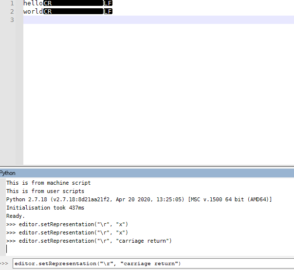

                Yes, it can be done, with the complication that it has to be done on every tab switch, because N++ “resets” this aspect of Scintilla when the active document changes. IMO it is better than hacking the exe.
                  All,
                  For most characters, re-asserting at every tab switch is sufficient.
                  However, in my experience, setRepresentation doesn’t work as expected for the CR and LF characters… when I tried editor.setRepresentation("\r", "x"), it gives
                  – it shrinks the box width down to 1 character rather than two, but still tries to say CR instead of x. Similarly, a longer replacement like carriage return allocates enough space for the extras, but still uses the CR text.
                  (the results on \n for LF are similarly ineffective and unhelpful)
                  dailD 1 Reply Last reply Reply Quote 2
