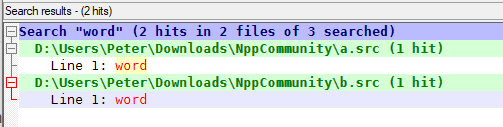

        As far as I know, Notepad++ does not have a way of showing which files were changed in a Find in Files replacement. However, if you do the Find in Files and do a Find All first, which will list all the matching files in the Search Results window; then you can do the Replace in Files, and it will replace all those instances. And even after you do the Replace in Files, if you double-click in the rows in the Search Results window, it will take you to the right row of whichever file the replacement occurred in.

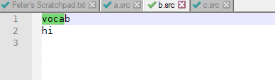

        For example, I created a.src, b.src, and c.src with word hi in two files and ward hi in the third, then did the Find All for word, then did the Replace in Files to change word into vocab =>
        double clicking on the lower instance (the word in b.src), it took me to the b.src with the line that now says “vocab”
        Not perfect, but hopefully works for you.
