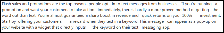

            Anyway, to answer what Neil was asking… I’m only talking about text sentences. Like this example:
            So, no real leading or trailing space issues ever in my examples. I just need to convert any 2 or more consecutive spaces found, into 1 space. It could be 2 spaces, or it could be 50 spaces. Totally random. ANd that includes between period and next character.
            So, to answer your question, it could be either 2 spaces, or many spaces.
