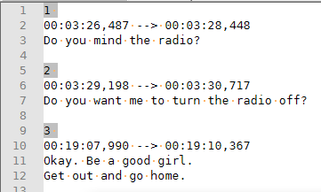

    Need numbers going up on every blank line followed by a previous line break for subtitles
    4 Posts 2 Posters 501 Views
    • Clayton LewisC
      Clayton Lewis
      (Before)
      00:03:26,487 --> 00:03:28,448
      Do you mind the radio?
      00:03:29,198 --> 00:03:30,717
      Do you want me to turn the radio off?
      00:19:07,990 --> 00:19:10,367
      Okay. Be a good girl.
      Get out and go home.
      (After)
      1
      2
      3

        5. Convert the smilies back to newlines: FIND = ☺ REPLACE = \r\n SEARCH MODE = regular expression, REPLACE ALL => 9d9ba985-d000-44d6-a3ad-4ad64fd93f2e-image.png

          Awesome, thank you very much! worked like a charm except for step 3 part 2-4.
          Scrolling down to the last line before the first character then holding Shift + Alt did the trick.
