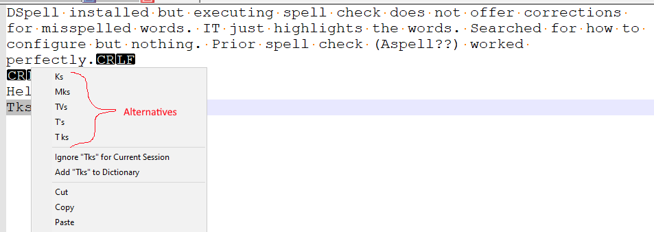

        It seems to offer alternatives through the right-click menu option, see
        I am on 8.1.4 although I’m not aware of any changes in DSpellCheck to fix any problems. This is a “temporary file” (new 2). Are you checking a “program” file, what is your extension because there was an issue with other types of text files a while ago. Maybe you have the same problem. I’m trying to locate that post now.

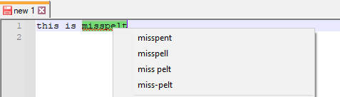

          DSpellCheck works just fine with Notepad++ 64-bit v7.9.2.

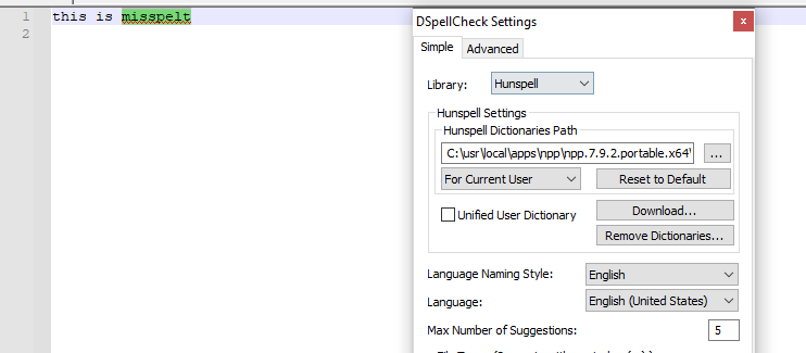

          With the Hunspell dictionary (the default, and the easier one to use), you just have to 1) install the plugin, 2) select Hunspell dictionary, 3) click the Download button and select the language(s) you want for spell check, 4) type a misspelt word.
          I was just able to unzip a fresh NPP v7.9.2-64, install the plugin, and set it up and working in less time than it’s taken to type this post so far:

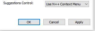

          There is a configuration for it: at the bottom of the Simple tab in the configuration, it has a pulldown for “Use N++ Context Menu” (default) vs “Special Suggestion Button” (non-default)
