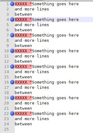

        If you use Search > Mark, and enable Bookmark line, search for XXXXX " , which will bookmark each of the lines. Then use Search > Bookmark > … to perform bulk operations on each of the bookmarked lines, like copy or delete or navigate between

            it only marks (the peachy background) the prefix. But the bookmark (the blue circle) applies to the whole line. If I then do Search > Bookmark > Copy Bookmarked Lines, it puts the whole line into the copy buffer. For example, I did that, and now am pasting it into my reply:
            XXXXX "Something goes here
            Notice that it got the whole line, not just the highlighted text.

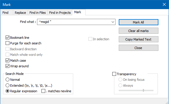

                You’d do the marking operation with this setup:
                So that the Find what text is copy/pastable, here it is: ^msgid "

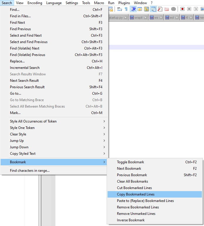

                    Run the marking operation I described, to obtain:
                    Run this menu command:
                    Create new tab (press Ctrl+n) and past (Ctrl+v) to obtain:
