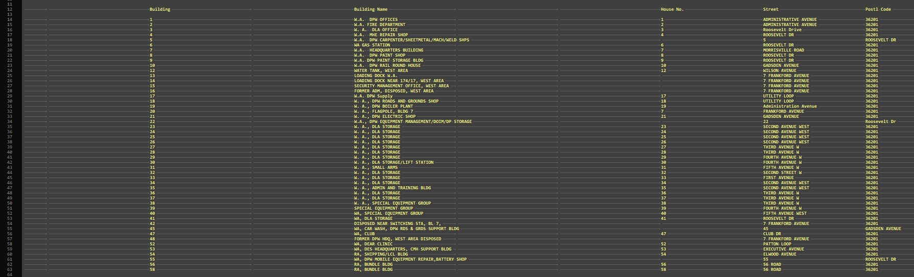

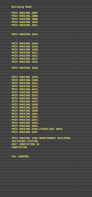

                Robert J Melascaglia @PeterJones
                @PeterJones - Agreed some images are required. I will start with the big picture.
                The paginated report, for whatever reason puts TABS between data-columns after the report aligns the report layout for printing. Your first suggestion (Find = \t+ and Replace = \t) performs just fine.
                The problem is shown by the second snip at the column level.
                As I mentioned previously; but realize a picture is worth a 1,000 words, “I have to First, replace that missing data with something line a “space-TAB” combination, so there is now at least a space at every row. Then I could use your suggestion to remove all unnecessary TABS.”
                The snips should help to understand how I am trying to cope with this paginated report. I appreciate your insight, thank you.
                  PeterJones @Robert J Melascaglia
                  @Robert-J-Melascaglia said in Converting paginated TXT file to Table layout:
                  And as I mentioned, you can do the smiley-face replacement to accomplish that. (and the implication of that suggestion was after doing the smiley transform, you would then do the tab reduction from my earlier post, and then you would turn smilies back into empty fields by just deleting all smiley characters.)
                  If that is not sufficient, you’ll need to be more explicit as to why. Because your pictures have done nothing to convince me my suggestion won’t work.
