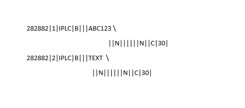

      No the spacing was removed so thought the image might be better. How can I retain the spacing? Thanks

            282882|1|IPLC|B|||ABC123 \
                                                              ||N||||||N||C|30|
            282882|2|IPLC|B|||TEXT  \
                                                    ||N||||||N||C|30|
            Got it (hopefully) thanks.
            • Darren BrownD
              Darren Brown
              So I would like it to be -
              282882|1|IPLC|B|||ABC123||N||||||N||C|30|
              282882|2|IPLC|B|||TEXT||N||||||N||C|30|
              Thanks
