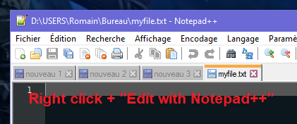

      If I open a txt file by right-clicking on it and clicking “Edit with Notepad++”, when Notepad++ opens, I am getting my documents that were opened last time:

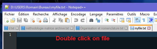

      But if instead, I double-left-click on the file to open it directly, I have totally different documents opened (I knew they were opened in a previous session of mine, they did not came here by themselves) :
      It is like there was “two different timelines”, with a different session depending how I open notepad++.

      • If I open N++ by launching in in the Start menu, I am having the same session as the “right click” one
      • If I open N++ with “left click” and try to open another file with right click, nothing happens (the file does not open)
      • What is stored in %appdata%/Roaming/Notepad++/session.xml is the content of the “right click” session
