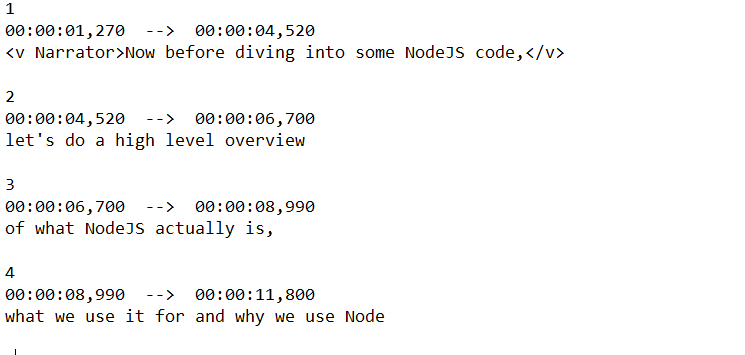

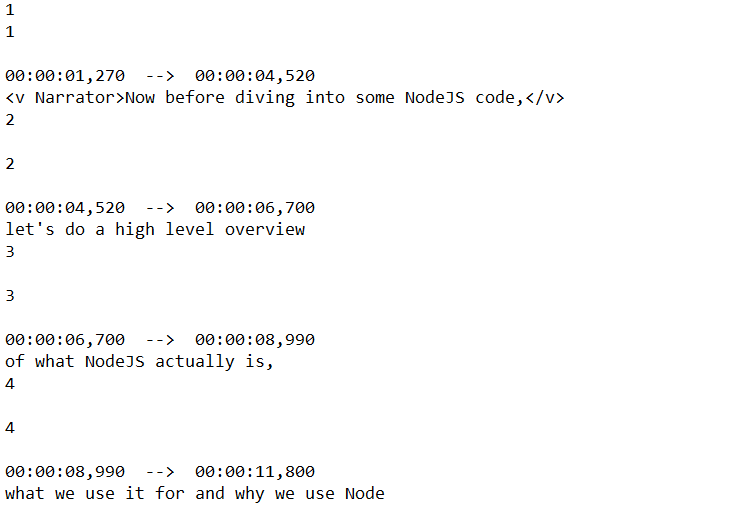

      This is my srt file:
      How to change it like this:

        Given the example data and assuming a Windows formatted document, the following regex should work:
        Search:		(?s)^(\d+)\R+?(\1)\R*?(?=\d+:\d+:\d+,\d+)
        Replace:	\r\n$1\r\n
        Put the caret at the very beginning of the document, select the Regular Expression mode and click on Replace All.
        Hope this helps.

          @astrosofista
          This is amazing!! A great solution.
          I spent a long time looking for a solution. Thank you very much!
