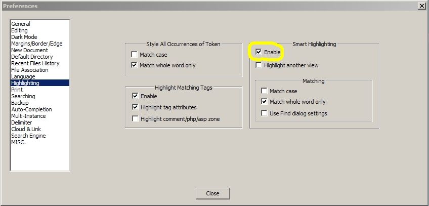

        Are you sure ‘Smart Highlighting’ is enabled in the [ Preferences > Highlighting ] menu?
        Michael D. DoubetM 1 Reply Last reply Reply Quote 0
        • Michael D. DoubetM
          Michael D. Doubet @artie-finkelstein
          @artie-finkelstein Yes, I’ve tried it both ways, Just tried it again, still no joy
