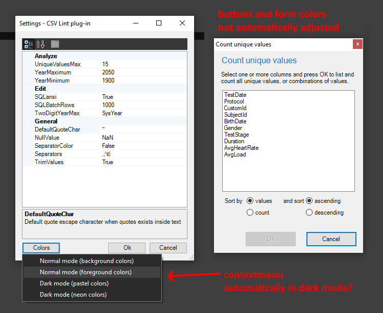

              Another thing, I’ll just ask it here as it is related. The plug-in has a couple of forms and dialogs, I haven’t adjusted the form or button colors so in Dark Mode they appear the same as in Normal Mode, this is what I expected.
              However, I noticed that one ContextMenu is adjusted to Dark Mode colors, why is that? And this got me wondering, is there a way to have all the forms and dialogs and buttons adjust to the dark mode colors? Is there a function I can send the form as parameter, and Notepad++ “washes” all widgets on the forms to Dark Mode colors?
