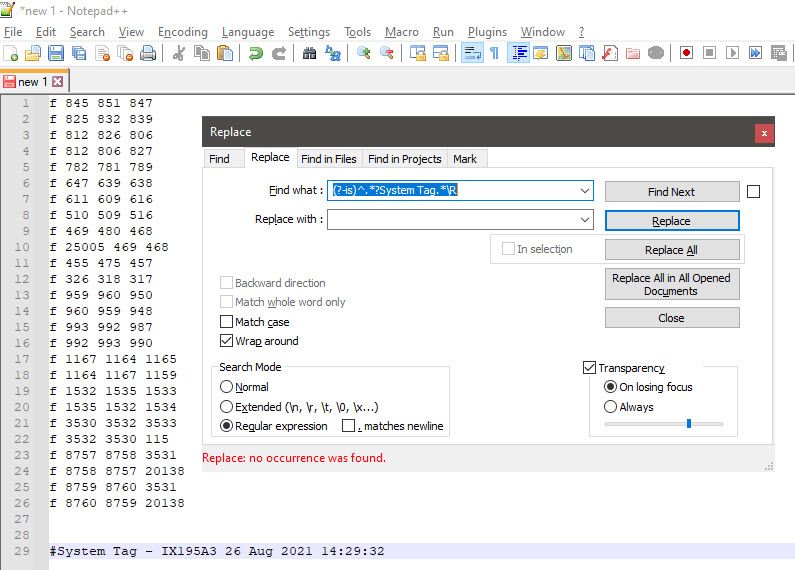

              @Alan-Kilborn Thanks for this alan, but think i’m missing something and just can’t get this to work. I have included a screenshot for the exact method im using and it still returns no results in the “replace” dialog box.
              Do you have any ideas where I could be going wrong?

                Your last line, which is the one that has System Tag on it, does not have a newline sequence, so \R has nothing to match. (?-is)^.*?System Tag.*(\R|\z) should work (see “Anchors” in the usermanual regex section)
                Gary SmithG 1 Reply Last reply Reply Quote 1

                  Worked flawlessly , thanks a lot folks for all your help, just saves me a whole bunch of work :)
