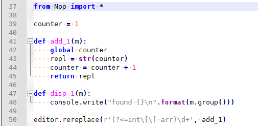

            I think the forum again consumed the backslash in front of [ and ] in your code. I think this should be the correct line in the code:

            Aside from the forum posting error I mentioned, Peter gave you everything you’d need for what you asked for – did you even try to follow the step-by-step-spoon-feed-me instructions?

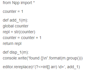

                tried it
                step by step
                and it did nothing
                this is what copied:
                from Npp import *
                counter = 1
                def add_1(m):
                global counter
                repl = str(counter)
                counter = counter + 1
                return repl
                def disp_1(m):
                console.write(“found {}\n”.format(m.group()))
                editor.rereplace(r’(?<=int[] arr) \d+', add_1)

                  Just a note to say it worked perfectly when I tried it, of course with the slight tweak I made to it because of the forum posting error (as detailed above).

                    If that’s literally and exactly what’s inside your Notepad++ window when editing the script, it is definitely not going to work, as that’s not valid python code.
                    As @Alan-Kilborn said, the forum got rid of two backslashes, as he showed in a screenshot earlier. So you need to make sure you include those backslashes
                    (please note: mine starts at line 37 because I also have all the other lines from the black box in the saved *.py file – those are comments, and can be saved as part of the script for future reference)
