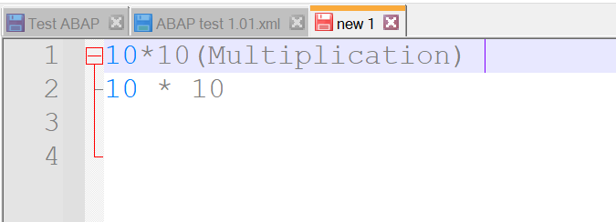

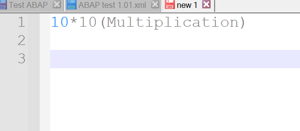

      How do I prevent the two from conflicting?
      For example, if I do 10 * 10 | After the * symbol it will comment instead of being an operator.

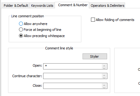

        Okay, assuming this is still ABAP from before, I just did a quick search on “ABAP comments” and found this… if I skimmed that correctly, * only indicates a comment at the start of a line. That makes it easier, and there is a feature built into Notepad++'s UDL to work with that.
        That’s why Comment & Number has a Comment line style with the line comment position – set it to “Allow preceding whitespace”, which means that the * has to be the first non-space character on the line.

            Please note that if you choose force at beginning of line rather than allow preceding whitespace, it should mostly work for the ABAP comments… but if you have a comment-line as the first line, it won’t always recognize that as a comment, whereas allow preceding whitespace will more reliably recognize it.

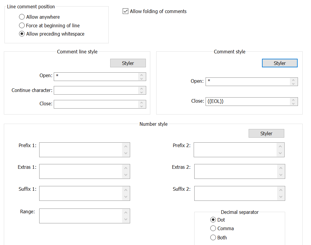

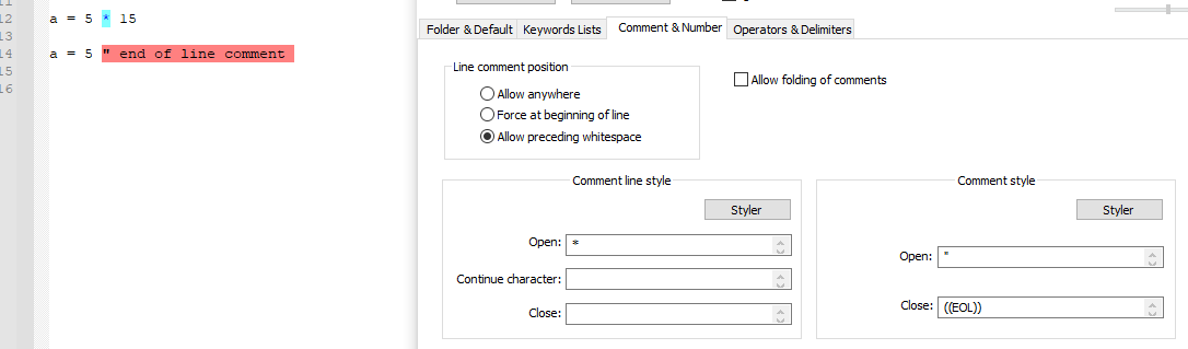

              The built in feature doesn’t seem to be working. Even when I use force at beginning of line or allow preceding whitespace. It seems to comment out instead of being an operator.
              daead771-5a30-484d-b304-7df312d1d323-image.png 0aa7db6d-a9be-4e04-855c-e544a7ac591a-image.png

                That’s because you changed what I showed.

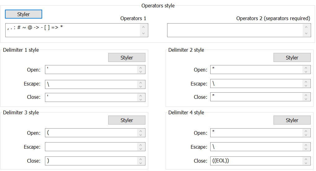

                In the right comment style box, I had a ", not a *. If you use the right comment style with an asterisk, then always and anywhere, asterisk-to-end-of-line is a comment, which is not what you want.
                  … actually, you’ll probably not want the " to ((EOL)) on the right-side “comment style” at all, since you have it as a delimiter already.
