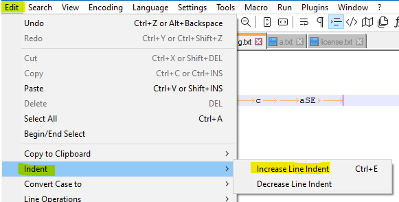

                So I experimented with this command on the Indent submenu of the Edit main menu (by assigning it a dummy keycombo, Ctrl+e):
                This also seems to do what you want?
                OK, not 100% on that because I’m not you. :-)
                But you might want to experiment with it.
                If it worked out, you could forget using a script, and just reassign the Tab and Shift+Tab commands, over to those shown in the screenshot.

                  The Increase Line Indent feature works kind of different. The caret is not moved at all when indentation is increased. It stays at the current/previous position. So the script solution to modify SCI_SETTABINDENTS is needed.
                  Taking the example from the other thread:
                  1. Have text in one line: column 0 starting with 8 spaces, at column 9 following some text.
                  2. Caret is at column 0.
                  3. Increase Line Indent.
                  4. Indentation is increased (test starts at 13), but caret stays at column 0.
                  And other way round
                  2. Caret is at column 11.
                  4. Indentation is increased (test starts at 13), but caret “stays” at column 15.
