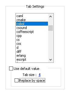

        PS (edit): I forgot to mention that I had to go to Settings > Preferences > Language > Tab Settings, and set cobol to not replace by space:

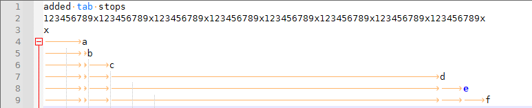

                This merger of Eko’s script and mine comes close… I merged my proof-of-concept with Eko’s fancy wrapper-registering to give different updates on a per-language basis, and then checked against the suggested flow from 2 years ago
                But I couldn’t find what message(s) were meant by the suggested on_update_ui. I think it might have to be one or more Scintilla Notifications for that, so it would use a separate editor.addCallback() in addition to the notepad.addCallback()
                So with this version, it will update the tabs whenever you change into a COBOL window or switch the active file’s language to COBOL from something else.

                  updated with a scintilla MODIFIED notification, with the caveat that it will only trigger for non-zero linesAdded value – that is non zero if a line is added or deleted.
                  it’s somewhat slow, but as you switch in to the file, or add or delete lines, the tabs will all be updated.

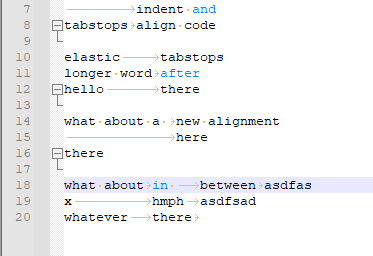

                    Does @dail 's Elastic TabStops plugin solve this? I honestly don’t know and haven’t tried it (never needed this), but sounds like it might?
                      PeterJones @Michael Vincent
                      @Michael-Vincent ,
                      I don’t use that either, but my impression was no. But I grabbed it to test briefly.
                      the tabstops in Elastic Tabstops will stretch to fit the longest piece of text: for example, with what about, x, and whatever, the first tabstop will be wide enough for the what about. And it allows different stops when you give a blank line between paragraphs/sections… but I don’t see a way to pre-define specific widths.

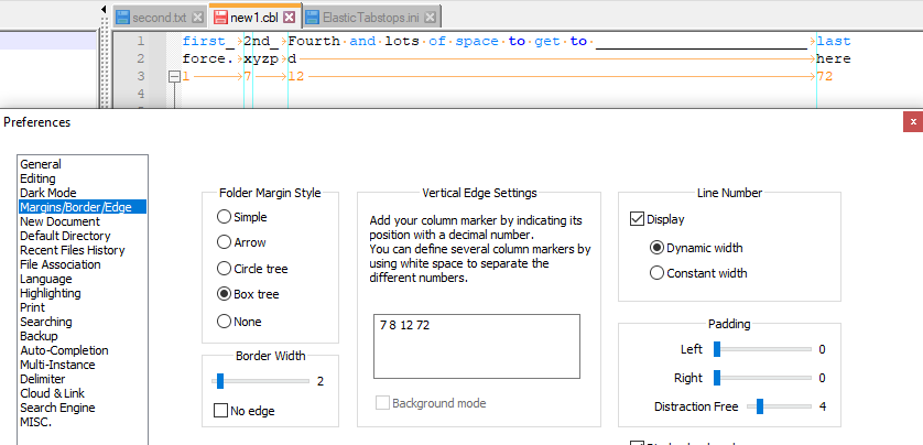

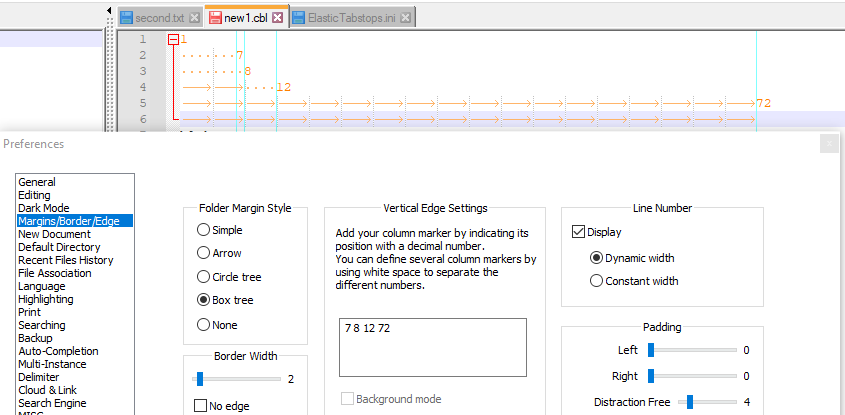

                        I don’t think anyone directly addressed this, either. With a recent Notepad++ version, you can have multiple vertical edges drawn: go to Settings > Preferences > Margins / Border / Edge, and fill in the Vertical Edge Settings:
                        That example doesn’t have the pythonscript callbacks active, so the tab size is a fixed width. Here it is with Elastic Tabstops also active, with a dummy header line to try to force known tab stops:
                        The drawback to the multiple vertical edges is that it is the same for all languages. Though that multiEdge example that @Ekopalypse linked to will actually solve that problem for you.

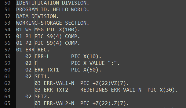

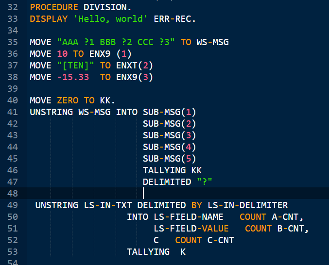

                          Eduardo Martines Teixeira @Emmad Kareem
                          @emmad-kareem I made a copy of the ‘Deep Black’ theme and renamed it to Cobol and incremented the following commands saved and put my cobol file in the themes folder, after the procedure I selected it in notepad ++ see if you like it.
                          Regarding the tab, I’m seeing how to solve it
