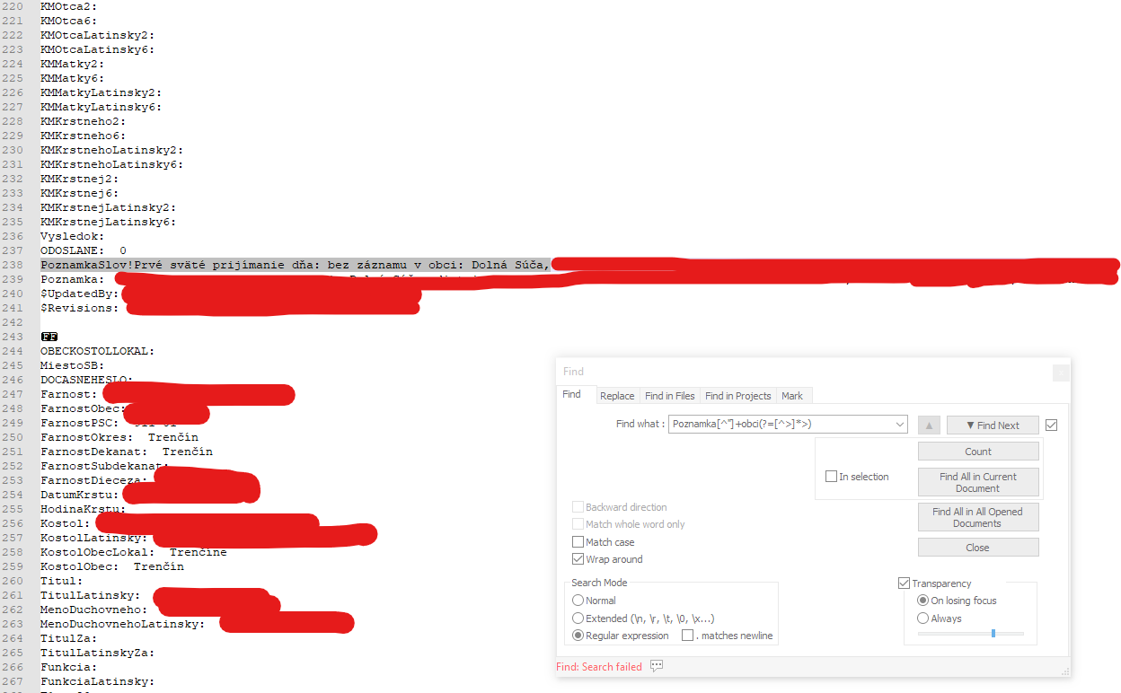

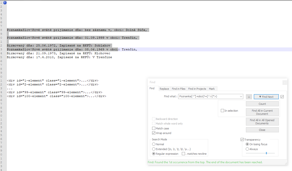

      When I copy my text in “new document” it marks more lines:
      and when I try it, in my document, it no work… and writes: “Serch failed, Unexpected exception while searching”:
      I don’t know if it’s even possible, but if you know some options, please help.
