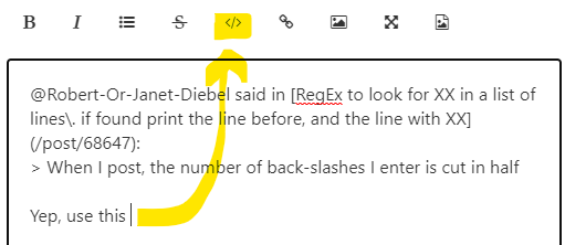

                    Alan Kilborn @Robert Or Janet Diebel
                    @Robert-Or-Janet-Diebel said in RegEx to look for XX in a list of lines. if found print the line before, and the line with XX:
                    When I post, the number of back-slashes I enter is cut in half
                    Yep, use this to avoid that situation:
