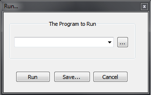

        Is this what you’re referring to?
        And you pressed save and it did not appear in the run menu?

          yes by entering C:\PythonPrograms\Python\Python38-32\python.exe -i “$(FULL_CURRENT_PATH)”
          When I save only get shortcut to program a key sequence
          Then when I close notepad++ and reopen the above python path is no longer there with blank entry as you show above so have to re-enter path again.

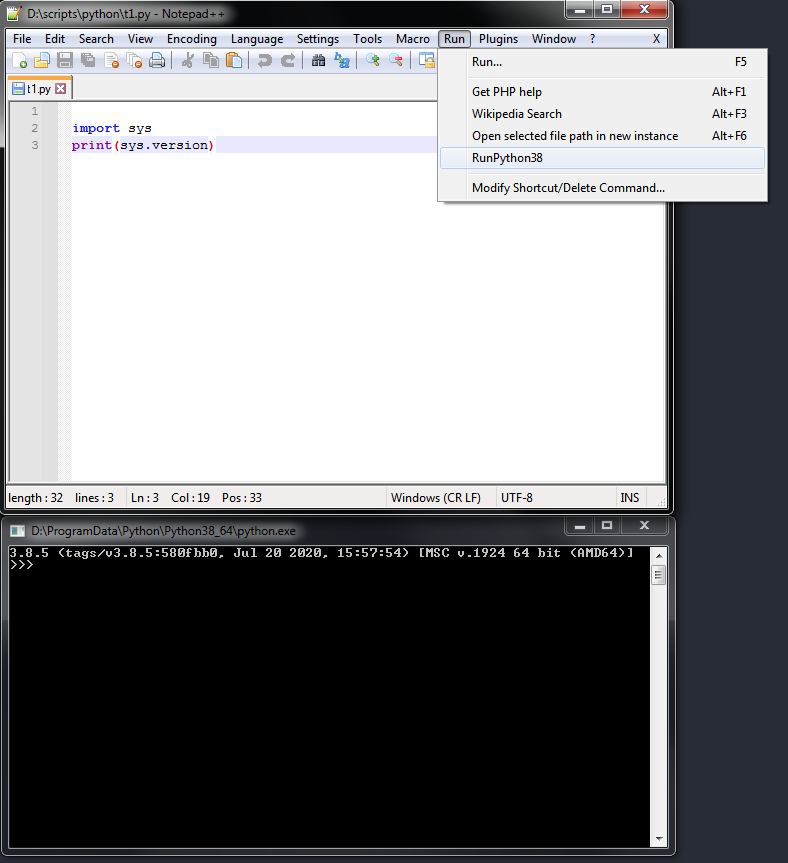

                If I understand you correctly, I cannot replicate what you reported.
                If I save a run command it gets saved and is accessible after Npp restart, see RunPython38 entry.

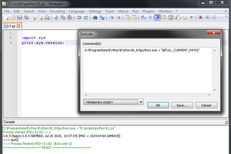

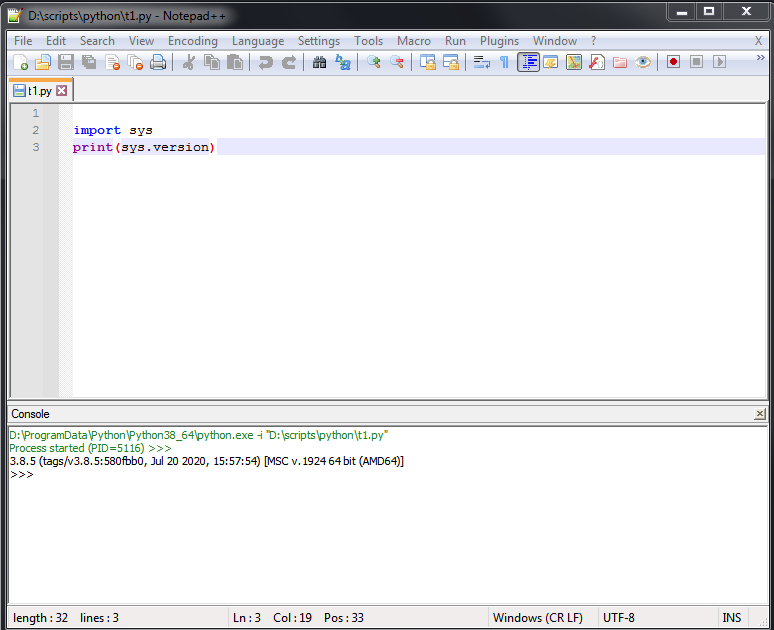

                If you run it with NppExec you get everything included into Npp
                Tested with

                    If it’s just to run a Python script, not even the -i switch is needed. Just ...python.exe "$(FULL_CURRENT_PATH)".
                    This has the advantage that you don’t have to exit the shell.
                    The script is executed and the result is displayed in NppExec’s console window.
