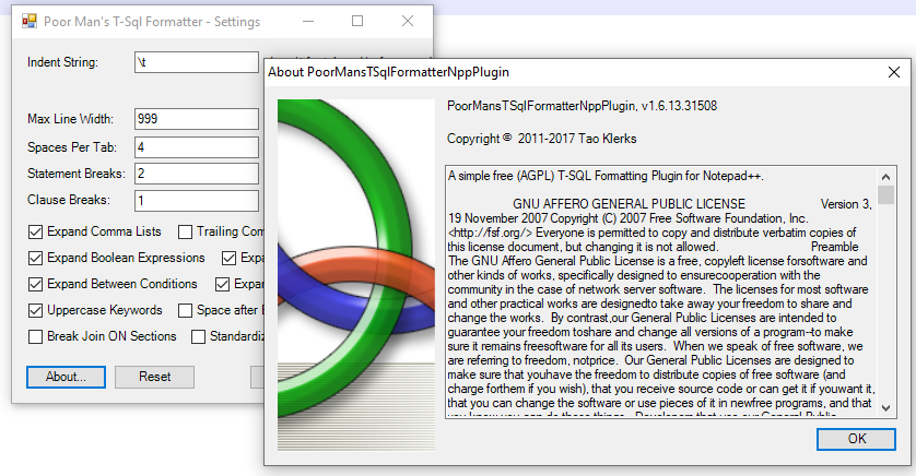

        I just installed Poor Man’s T-SQL Formatter 1.6.13.31508 with a fresh version of Notepad++ v8.1.2 64bit ; it had to install some ancient .NET framework files that I apparently didn’t have on my computer and said I might need to reboot due to .NET changes. The first time I ran Notepad++ after the install, it gave that error. However, I exited Notepad++ and re-ran it, and it loaded fine without error subsequently, even without a reboot.

        Notepad++ v8.1.2   (64-bit)
        Build time : Jul 16 2021 - 01:59:50
        Path : C:\usr\local\apps\npp\npp.8.1.2.portable.x64\notepad++.exe
        Command Line :
        Local Conf mode : ON
        OS Version : 2009
        OS Build : 19043.1110
        Plugins : mimeTools.dll NppConverter.dll NppExport.dll PoorMansTSqlFormatterNppPlugin.dll

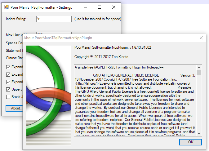

        As an experiment, I also tried installing it in a portable v8.1.2 32bit (you said you had 64 bit OS, but not which Notepad++ bitness you used). Since I already had the .NET installed, it didn’t pester me about that; it installed just fine, and even on the first run, it didn’t give the error, and loaded Notepad++ just fine, and the ABOUT box for the plugin shows that v1.6.13.31502 is running (apparently, the 32bit has a different build number in the final digits of the version string)
