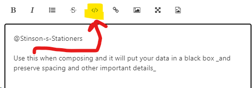

                      Alan Kilborn @Stinson's Stationers
                      @Stinson-s-Stationers
                      Use this when composing and it will put your data in a black box and preserve spacing and other important details
                      If you’ve done it right it will appear like this:
                      If you've done it right it will appear like this:
