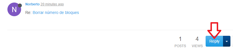

        FYI, you don’t have to create a whole new topic to reply; you can just click the “Reply” button:
