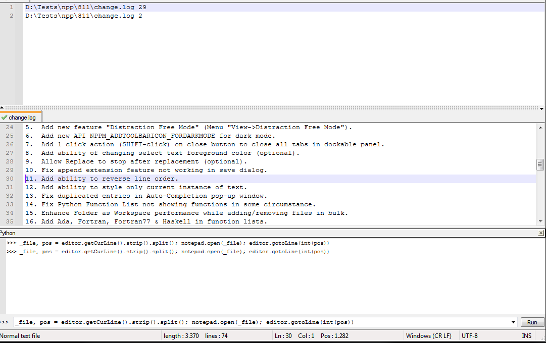

          I changed your code a bit, to:
          p = r'd:\blah.txt'
          print("Opening "+ p + "...")
          notepad.open(p)
          line = 12
          print("Going to line " + str(line) + "...")
          editor.gotoLine(line)
          and, running it, it didn’t have a problem opening the file and moving to the correct line.

                  Alan Kilborn @Anthony Blinco
                  @Anthony-Blinco said in Python gotoLine() Not going to line after Open():
                  if word wrap is on it doesn’t work (For my primary file, not the loaded file).
                  So what didn’t register with me is that “word wrap” is a global setting, it affects all files. So if you have one “wrapped” you have them all “wrapped”. So saying something like “word wrap is on…for my primary file not the loaded file” isn’t really a valid statement.
                  So yes, I think in light of that plus @dail 's input, a lot more is starting to make sense now as to what is happening for you. :-)
