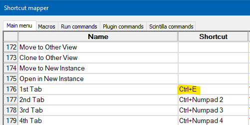

              I used 8.1, and since I don’t have a numeric keypad on my keyboard, I remapped the 1st Tab command thusly:

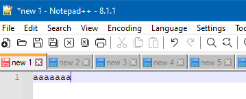

              Then I used the < button to move back to new 1 and made it active:

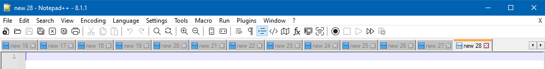

              Then I used the > button to move so that new 1 was not visible:
              And then I pressed my Ctrl+e, expecting to see new 1 again shown in the tab bar, but nothing happened.
              However, I now notice that the editing content is really still showing the new 1 content, even though the tab for new 1 is not visible.
