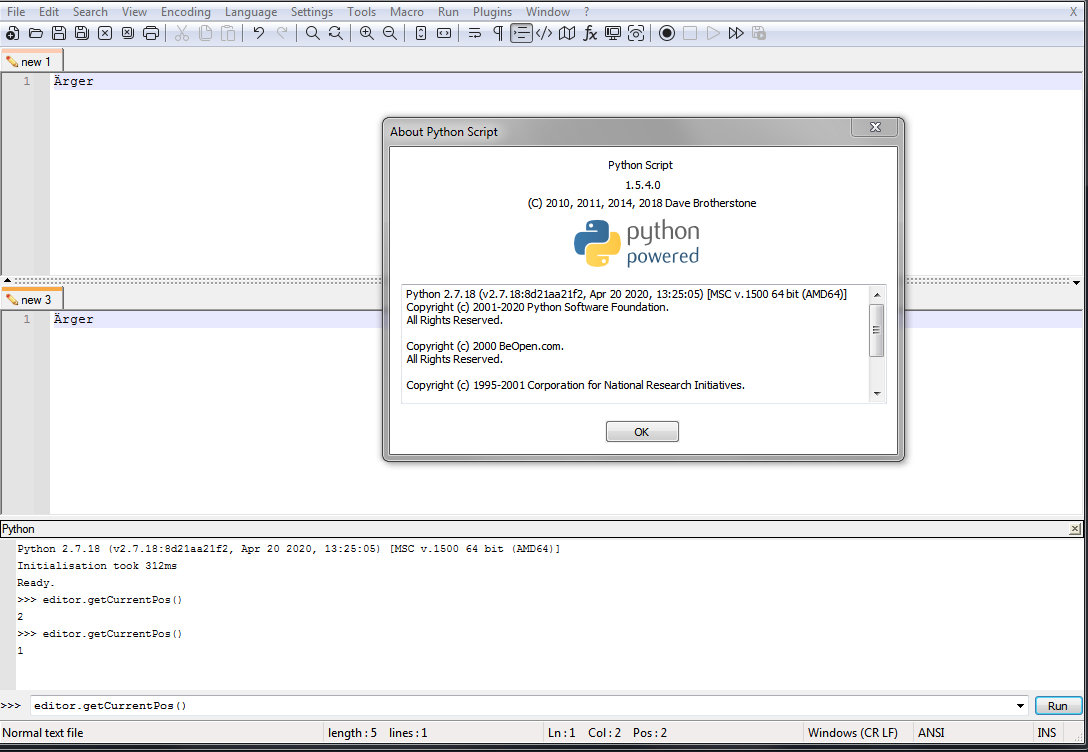

            @DaveyD
            Seems to work for me. new1 is an utf8 encoded and new3 an ansi encoded buffer. The cursor was placed directly after the Ä in both cases.
