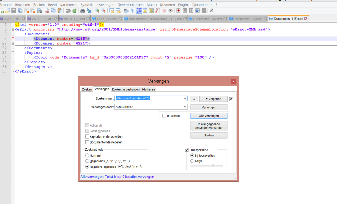

      I do not want the document number in my XML File.
      I tried search and replace but don’t know how to use it in the right way.
      What do i need to SEARCH for if i want all the <Document number=“[0-9}”> tags need to be replaced with the tag: <Document> ? Or is there an other way to delete these numbers.
      Below an example of the XML file with 2 documents
      • astrosofistaA
        astrosofista @Sandra Treffers
        @Sandra-Treffers, All
        You were close. One way to solve it is the following regex:
        Search: (<Document) number="[\d]+">
        Replace: $1>
        Put the caret at the very beginning of the document, select the Regular Expression mode and click on Replace or Replace All.
        Hope this helps.
