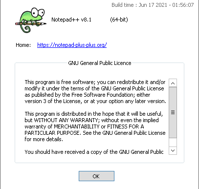

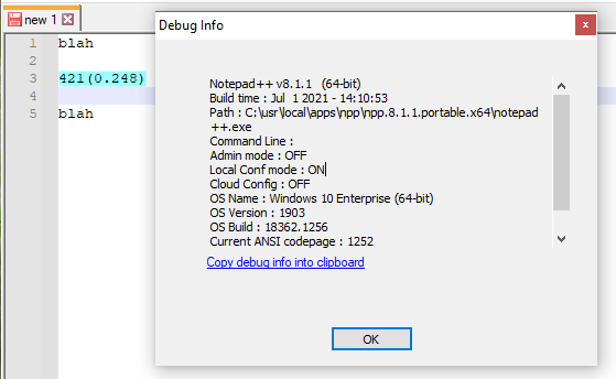

        • What version are you using (?-menu, Debug Info)

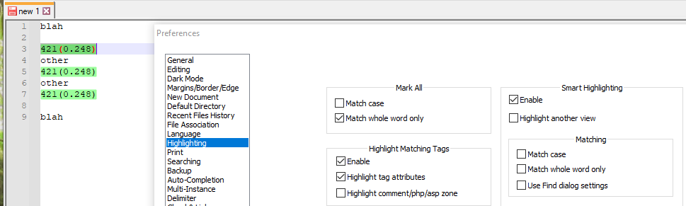

        Because you said “style token”, I thought maybe Search > Mark One > Using 1st Style, which works:
        Or, select the first 421(0.248) when there are multiple instances of that in the document, then Search > Mark All > Using 1st Style, which also works:

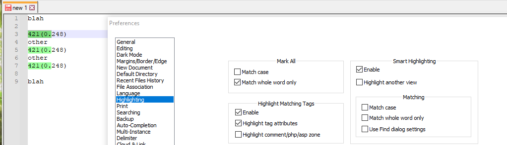

        But maybe you mean the smart highlighting, where you select one instance, it will temporarily highlight all the matches. If I do that on the 421 or on the 248, it does the highlighting:

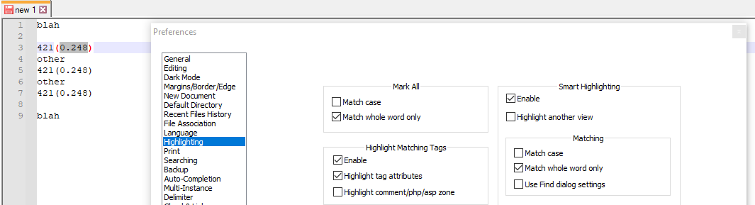

        … but if I cross over the . in 0.248 or across a parenthesis, then it won’t:

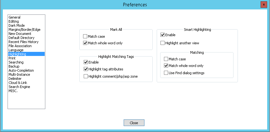

        … As you might be able to guess from my wider screenshot, which shows Settings > Preferences > Highlighting, I am about to show you that by un-checking the Smart Highlighting > Matching > ☐ Match whole word only, it will go back to working, even if you cross a boundary:

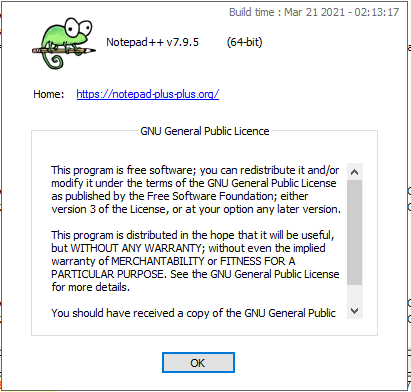

          I´ve got different versions of npp. On one server this is the version:
          Here everything works just fine, just the way I want it. Default settings does the job;
          873(0.59) is highlighted with style token nr 1. This is with match whole word only ticked.

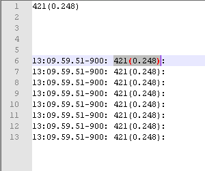

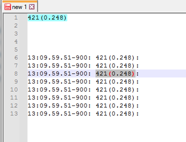

          I´ve copied 421(0.248) from row 6 to row nr 1, so the format is the very same.

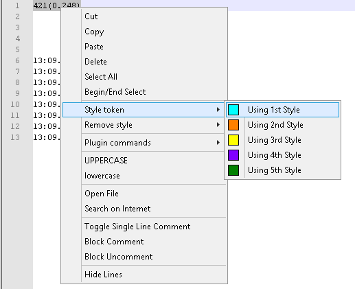

          If I mark the first row, it doesn´t get highlighted:
          These are the settings:
          If I mark the same string on row 6, it still doesn´t get highlighted:
          This is as it´s supposed to due to my settings.

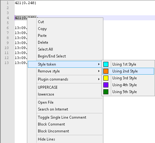

          However, if I mark the first row and add a style token to it, it works, but just at the very first row:
          I figured the : might have something to do with it so once again I copied the string from row 6, including the :.
          Then I get this strange result:
          As you can see, row 4 is marked, but the token only applied to the string on row 1.
          This just beats me :-)

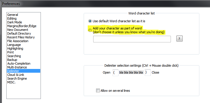

            @Markus-Sulk
            For the selecting issue:
            on the server where it is working, check the “word character list”
            I assume this has been modified.
            The styling issue looks like it is a bug.
            Fresh 8.1.1 version behaves like reported.

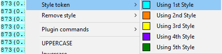

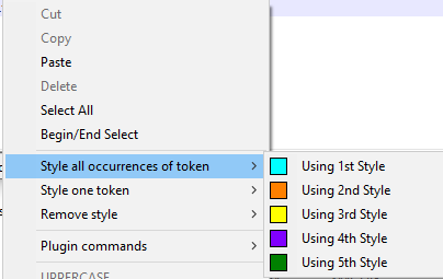

                Please note that your right-click context menu appears to be out of date, compared to my fresh unzips of v8.0, v8.1 and v8.1.1: There should be both “Style all occurrences of token” and “Style one token”
                (These line up with the v8.x menu system of Search > Mark All and Search > Mark One that I referenced in my first reply.)
                When you look at contextMenu.xml (Settings > Edit popup contextMenu), you should have both these groups:
                        <Item FolderName="Style all occurrences of token" id="43022"/>
                        <Item FolderName="Style all occurrences of token" id="43024"/>
                        <Item FolderName="Style all occurrences of token" id="43026"/>
                        <Item FolderName="Style all occurrences of token" id="43028"/>
                        <Item FolderName="Style all occurrences of token" id="43030"/>
                        <Item FolderName="Style one token" id="43062"/>
                        <Item FolderName="Style one token" id="43063"/>
                        <Item FolderName="Style one token" id="43064"/>
                        <Item FolderName="Style one token" id="43065"/>
                        <Item FolderName="Style one token" id="43066"/>
                If you only have one group (probably with id=“43022”-“43030” but a different FolderName), then you’ll want to paste the ones I just posted overtop, save, exit Notepad++, and re-run Notepad++. Now your right-click context menu should have both “style all occurrences of token” and “style one token”.

                New experiments show that it’s still affected by the checkmarks in the Preferences > Highlighting settings.

                2. Take the default settings in Preferences > Highlighting, select one without the colon and try to select one without the colon: It will not show any smart-match highlighting, and will only apply the marking-style to the ones without colons:
                3. Change Preferences > Highlighting to un-check Mark All > ☐ Match whole word only: now if you select one without the colon: it will still not show any smart-match highlighting, but will apply to the marking-style to the ones with and without colons:
                4. I won’t do a third video, but if you also un-check Smart Highlighting > Matching > ☐ Match whole word only, it will do the green smart-matching while you’re selecting it, even when you cross a boundary (like I showed in my original static screenshots)
                There is a section in the manual about how the Highlighting preferences affect things, but given that “Mark” has two meanings in Notepad++ (Search > Mark… which has a Mark All button, vs Search > Mark All/Search > Mark One which are called Style all…/Style one… in the right-click context menu), that may be ambiguous as to which is meant for that preference.
