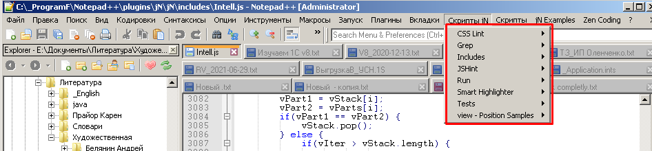

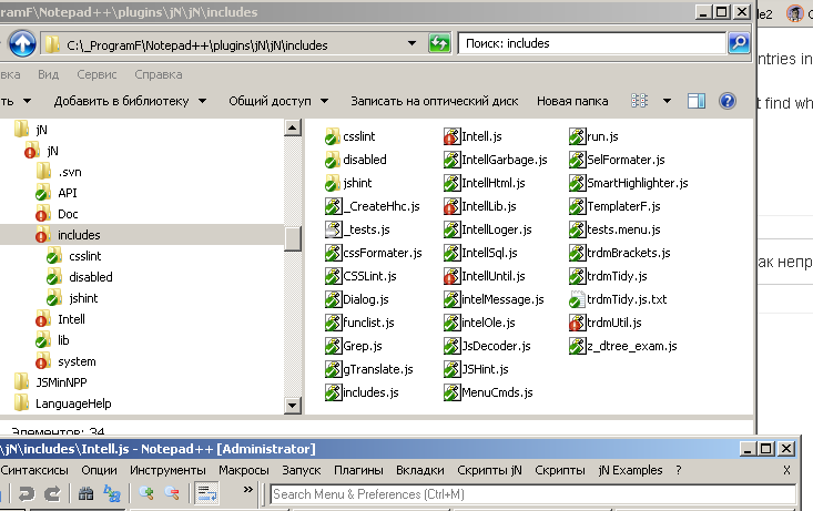

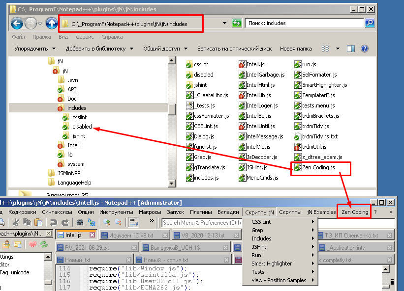

        I had a similar problem. These menus adds plugin jN. You can go 3nd ways:
        • Remove the plugin itself
        • Move *.js files from the “Includes” folder to the “Includes\disabled” folder
        • Adjust the menu in the scripts themselves.
        I preferred option 3. Add code to each script that adds the menu (up the script):
        // глобальная переменная с меню скриптами.
        if (!jN.scriptsMenu_jN){
        	var scriptsMenu_jN = Editor.addMenu("jN-Examples");
        	jN.scriptsMenu_jN = scriptsMenu_jN;
        } else {
        	scriptsMenu_jN = jN.scriptsMenu_jN;
        And edit a deadline for adding a menu:
        var CSSLintMenu = scriptsMenu_jN.addMenu(CSSLintMenuCfg);
        And so process all scripts.

                Troshin’s untranslatable screenshot appears to be showing that he somehow consolidated some of those into submenu’s of a top-level menu that he called “Скрипты jN” (“Scripts jN”) – I don’t know whether through re-compiling the plugin with code changes, or through some other plugin that edits other plugins’ menus – but even that goes against the design philosophy of Notepad++ plugins, which is to put all their menus underneath their entry in the Plugins hierarchy. And it didn’t take care of the others (the “jN Examples” menu and the “Zen Coding” menu)
                  Результат.
