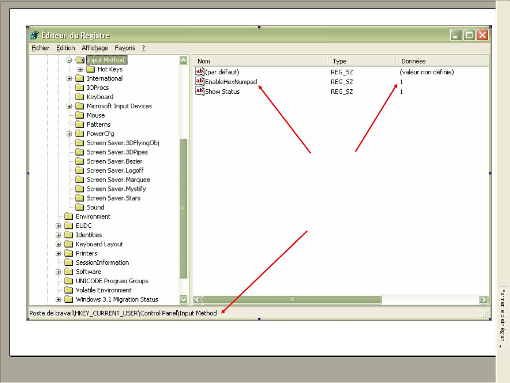

            Hi, @zsolt-kántor-0 and All,
            I don’t understand why you cannot achieve this operation ?
            • If I press, successively, the +, 0, 3, 8 and 8 keys, on the numeric keypad, while holding down the Alt key, I do get the Έ character ( GREEK CAPITAL LETTER EPSILON WITH TONOS ), once the Alt key released !
            Refer to https://www.unicode.org/charts/PDF/U0370.pdf
            • If I press, successively, the 0, 3, 8 and 8 keys, on the numeric keypad, I do get the „ character ( DOUBLE LOW-9 QUOTATION MARK ). Why ? Because :
              • First the decimal input 0388 is evaluated modulo 256 so, giving the decimal value 0132
              • Then, the character, of numeric value 132 ( and hex value 84 ) is the ANSI character „, which stands for the Unicode character of code-point U+201E ( DOUBLE LOW-9 QUOTATION MARK )
            Thus, may be, your system don’t have the recent Unicode input method ! In that case, you’ll have to edit the Registry and follow the method described in the Transition to Unicode chapter of this page :
            https://en.wikipedia.org/wiki/Alt_code
            which says :
            So a method was developed to enter Unicode, in Windows, using the hexadecimal code point. To enable it, a user must :
            • Set or create a string, of type (REG_SZ), value called EnableHexNumpad in the registry key HKEY_CURRENT_USER\Control Panel\Input Method\
            • Assign the value data 1 to this key
            • Reboot or log out/in
            => A leading +, on the numeric keypad, then allows entry of a hexadecimal Unicode value (using the main keyboard for A–F )
            dada aD 1 Reply Last reply Reply Quote 2
            • ZsoltKántorZ
              ZsoltKántor
              Thank you! The registry editing method solved my problem.

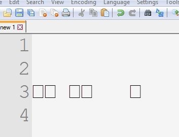

                I observed a strange behavior of Np++
                There are some unicode chars that are not displayed in the editor, but are well displayed in the Windows notepad.exe
                e.g.:
                U+2230 ( ∰ ) volume integral symbol
                U+2231 ( ∱ ) clockwise integral symbol
                In Np++ a box appears instead the symbol:
                In notepad.exe symbols look fine:
                  The fact that you see small boxes, instead of real characters, means that :
                  • Your current N++ font cannot handle these characters
                  • Your OS did not find out a substitute font to display the character glyphs
                  • Finally, your OS did not find out a fallback font, too !
                  As for me, I generally use the monospaced font Consolas and the current version of this font ( on my old Win XP SP3 laptop ! ) just displays boxes with an question mark inside !
                  But , if I change the default font in Settings > Style configurator... > Global Styles > Default style > Font style > Font name and choose, for instance, Lucida Sans Unicode or Microsoft Sans Serif or Tahoma, I do get the characters ∰ and ∱ :-))
                  I bet your Notepad.exe current font is Microsoft Sans Serif, isn’t it ?
                  Best Regards

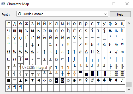

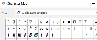

                      PeterJones @ZsoltKántor
                      @Zsolt-Kántor-0 said in Insert Unicode characters not working - please help:
                      notepad.exe font is Lucida Console and
                      Lucida Console does not have those glyphs, as of the version that came with my Windows 10 machine:
                      Lucida Sans Unicode does have them.
                      As @guy038 explained, Windows sometimes chooses a fallback font compared to the font you have set in a given application… But I’ve found that Windows favors doing that substitution in built-in Microsoft apps; whereas in externally-produced applications like Notepad++, Windows OS seems less-likely to apply the fallback fonts.
                      Sites like fileformat.info will show lists of fonts that do contain a glyph for a particular
                      • U+2230 ( ∰ ) volume integral symbol @ https://www.fileformat.info/info/unicode/char/2230/fontsupport.htm
                      • U+2231 ( ∱ ) clockwise integral symbol @ https://www.fileformat.info/info/unicode/char/2231/fontsupport.htm
                      So if you can find a monospace font there that meets your font licensing requirements, you could download that font and set it as the font you use in Notepad++. (What annoys me is that all of the Deja Vu fonts, except the Deja Vu Sans Mono that I use in NPP, support those glyphs.)
