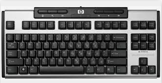

      Potential downsides:
      • destroys clipboard contents
      • doesn’t work for those without numeric keypad on their keyboard (and yes, there are those of us for which a keyboard with a numeric keyboard is a hinderance; thus mine):
