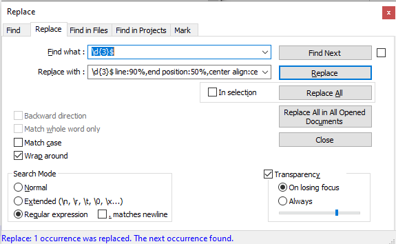

        @Alan-Kilborn Mmmm, I wasn’t able to get this solution to work (copying/pasting your suggestions into “Find” and typing in my text in “replace”. It gave me an error “zero length match”. I must admit, while I understood the other suggestions (and they worked), I don’t understand this one well, which is probably why I’m executing it wrong. Sorry, but thank you for the help!
          Alan Kilborn @Laura Stiles
          @Laura-Stiles said in Adding text at the end of only certain lines that end in a number (variation of numbers):
          it gave me an error “zero length match”
          That’s not an error message, it’s an informational message, with a little arrow indicator at where the match occurred.
          As you might think, if you find a zero length match, when you replace it, it doesn’t replace anything existing.
          But what it does do, is uses the location where the little arrow points as an insertion point for the replacement text.
          So… you could use my expression for Find what , with a Replace with of line:90%,end position:50%,center align:center to get at least close to what you want.
          See where the little arrow points?:
          One little caveat is that you would have to use Replace All with a find expression that uses \K like this one does. Replace of each occurrence one at a time doesn’t work (Notepad++ bug).

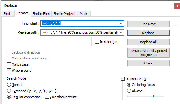

            Again, a word of warning: That was a dangerous solution (based upon your original input) that is wrong for a number of reasons. It uses the * in totally the wrong way (more like a command line file wildcard than a regular expression pattern repeater). It just so happens to be “okay” for this application.

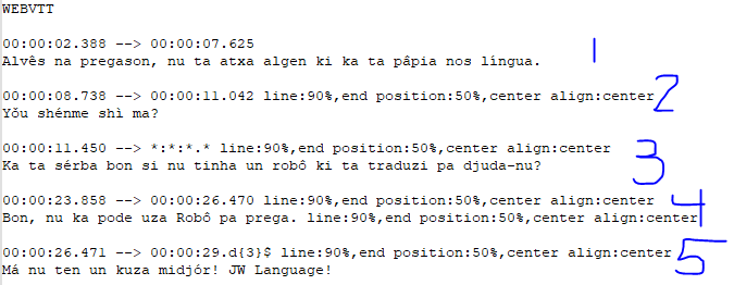

                The above regex will match this text: --> ::::::::::::::::::dddddddddddfffffjjjjea::::zefjaj which is clearly only like a timestamp in that it has the --> to its left!
                Basically, the regex will match --> followed by anything!!! DANGEROUS!

                  @artie-finkelstein and @Laura-Stiles ,
                  As Alan says, the --> *:*:*.* which first showed up in Laura’s screenshot and which Artie repeated does not do what Laura intended it to do, because it appears Laura was using * as though it were a Windows command line filename wildcard, to match "--> followed by a space, then anything, then colon, then anything, then colon, then anything, then dot, then anything. Regexes use different syntax than MS cmd.exe.
                  • --> matches that literal text
                  • * (space star) matches 0 or more space characters
                  • :* (colon star) matches 0 or more colon characters
                  • .* (dot star) matches 0 or more of any character
                  So it was matching “literal --> followed by 0 or more spaces followed by 0 or more colons followed by 0 or more colons followed by 0 or more of any character”. “0 or more” of the spaces and colons mean it can get to the space beyond the -->, then the “0 or more of any character” matches the rest of the line, whatever it happens to be. When you piece it all together, Alan’s brief description of “Basically, the regex will match --> followed by anything” sums it up.
                  So what was “scary” about the regex is that it appeared to work, but for all the wrong reasons, and to use it thinking that it was matching the pattern that was intended is foolhardy.
