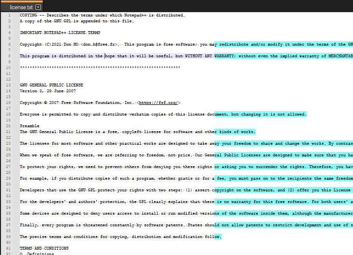

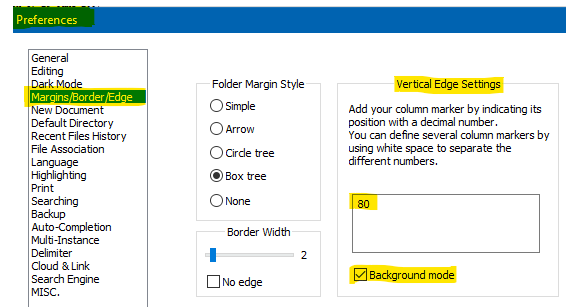

        While you can’t restrict line-length, you can set something up to get a visual indication for problem lines; an example setup:
        Produces a look like this:
        which clearly identifies long lines in cyan color. The color can of course be changed to whatever you like.
        If you’d like something that will explicitly inform you of long lines, I can assist you in writing a script to do so. Post back if you’d like to try this approach. Here’s an existing script that might help: https://community.notepad-plus-plus.org/post/35567
