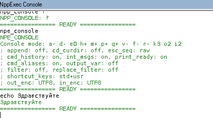

                  • If you are using NppExec
                    • Show an example of the code you ran, with a screenshot of the “bad” results
                    • Show the output of npe_console, which will tell us what input and output encodings you are using: for example, mine is 50cfad57-c0f8-4221-99ba-8b67e3ad582a-image.png

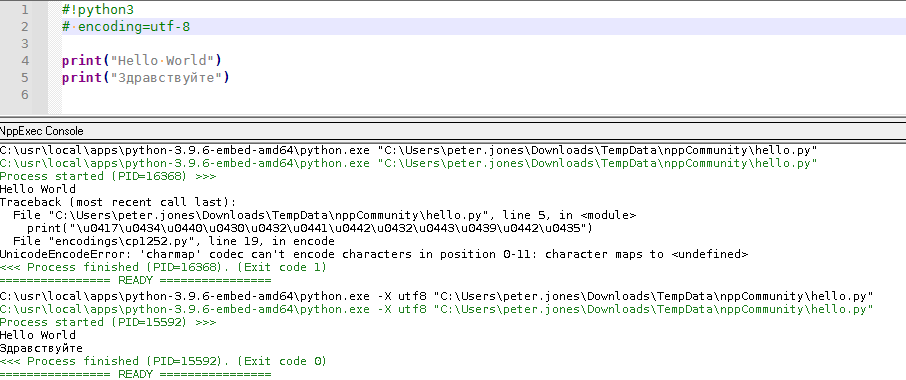

                    If you are using NppExec…
                    I didn’t have a python executable installed on this machine (pythonscript’s DLL is sufficient for my python needs), so when I had a couple spare minutes, I downloaded the “Windows embeddable package” (the minimalistic Python3 executable, which can be embedded, or is otherwise “portable”).
                    #!python3
                    # encoding=utf-8
                    print("Hello World")
                    print("Здравствуйте")
                    When I ran from the command line, I got
                    showing that the code was good.
                    When I tried to run from NppExec’s console, I got a UnicodeEncodeError. When I changed my python command line to invoke the -X utf8 option, then it worked inside NppExec’s console as well. Both these runs are shown in the screen cap below:
                    So, if I use the NppExec script
                    cd "$(CURRENT_DIRECTORY)"
                    C:\usr\local\apps\python-3.9.6-embed-amd64\python.exe -X utf8 "$(FULL_CURRENT_PATH)"
                    … then it properly outputs UTF8 text for me.
