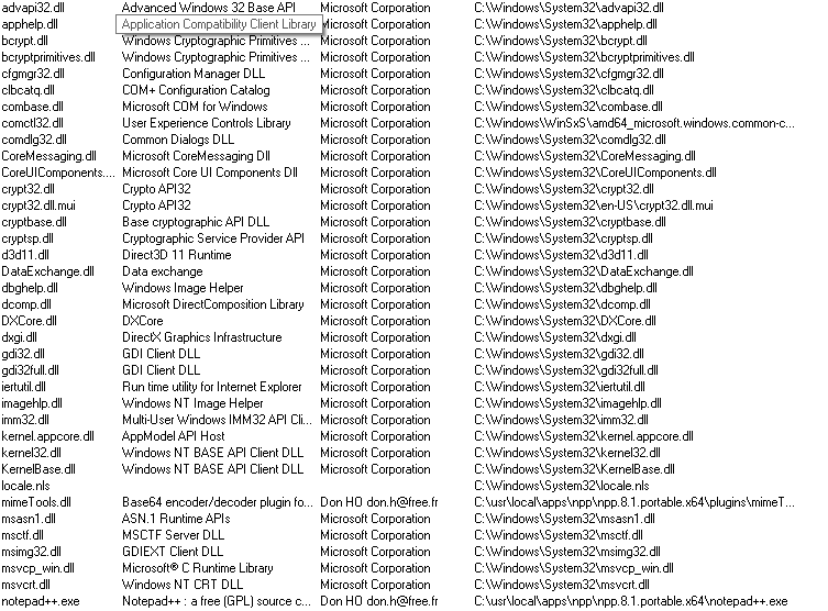

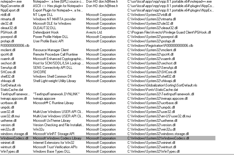

          With a portable v8.1-64bit with no non-default plugins installed, Process Explorer shows me:
          (two screenshots because it was too many for my monitor)
          I don’t know if that will help you or not.
