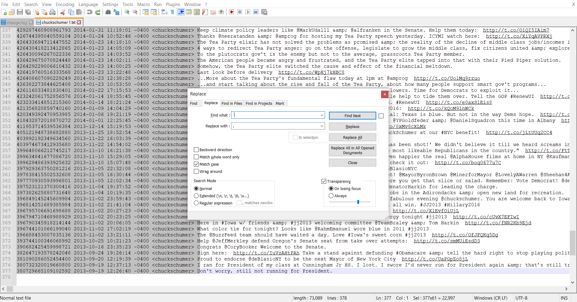

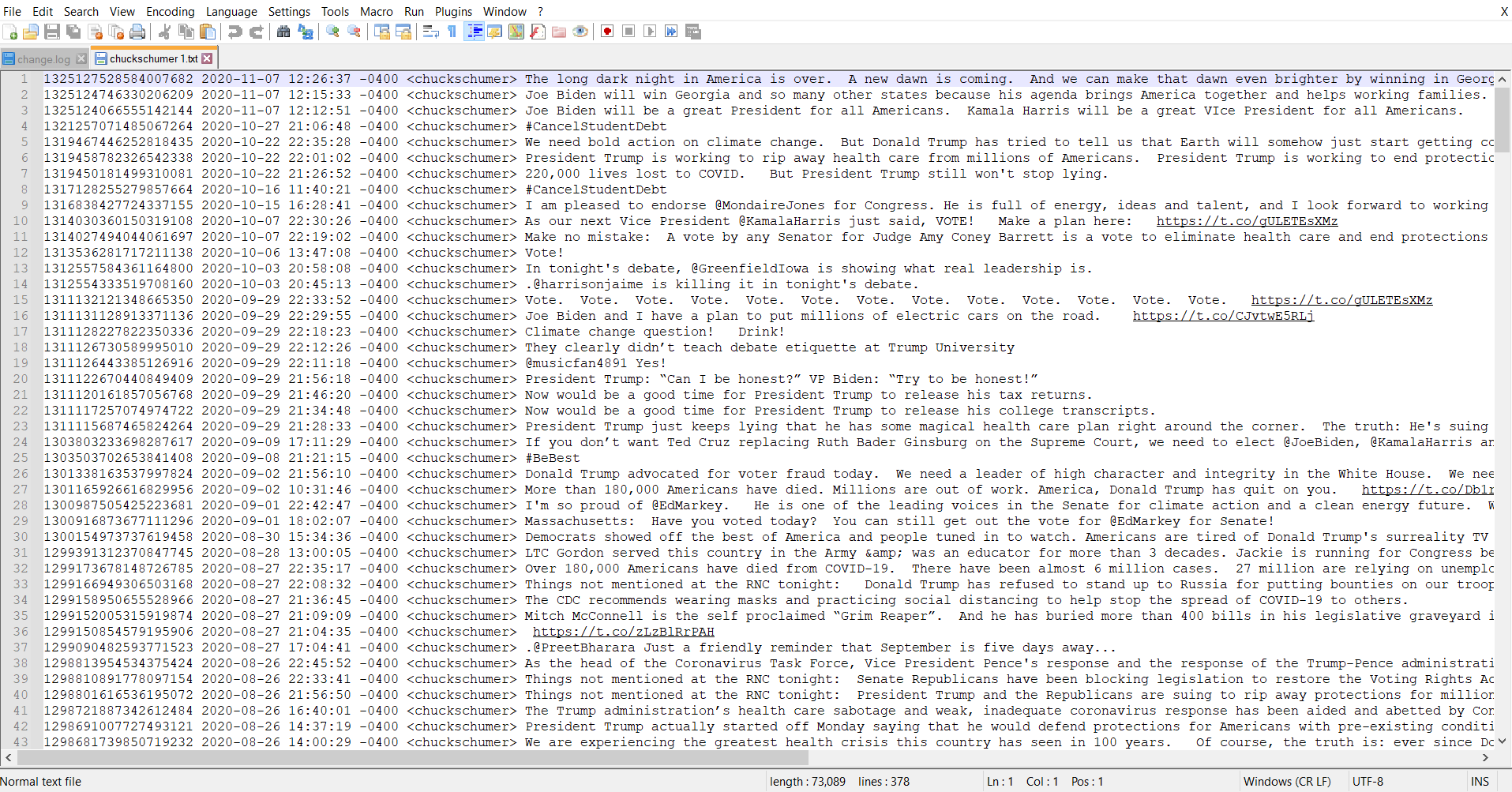

      I have some twitter data in the form of TXT files that I’m using for academic purposes. For example, here’s some tweets by Senator Chuck Schumer:
      Chuck Schumer
      As you can see there’s a tweet code, date and time, time zone code, twitter handle, and the content of the tweet, and the sections are delimited by space, which is obviously an issue as the contents of the tweets contain many spaces. I tried column select but replace in selection is greyed out
      Replace all works fine here but I can’t select the specific columns (option is not greyed out if normal select is used). I was thinking about using Regex for this but I’m not sure how to get it to do what I want. Ideally code where I could simply replace the first five spaces in a line into commas would be ideal, since tweet code lengths can vary a little as you go back, but I don’t know how to do that. Maybe a Macro?
